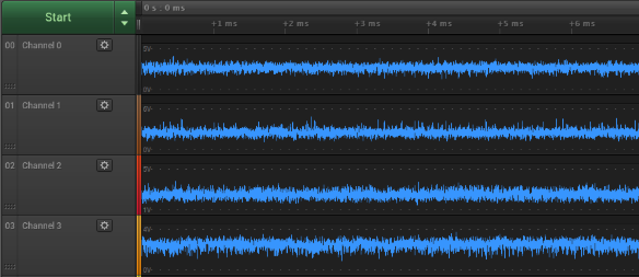

The Analog Capture Looks Extremely Noisy
Even with the Logic hardware inputs disconnected, the analog capture may look like the image below. The solution is to simply download the latest version of Logic software. We made some incremental changes to the Logic hardware (no new functionality) that makes it incompatible with Logic software versions prior to 1.2.15.
