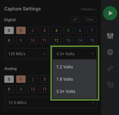

Logic Pro 8 and Logic Pro 16
Logic Pro devices have three selectable voltage threshold options. This setting applies to all the input channels simultaneously.
Logic Pro 8/16 - Voltage Threshold Setting in the Logic 2 software
The inputs are also implemented with comparators instead of standard CMOS buffers found on Logic 4 and Logic 8. This makes the input-low and input-high voltages very close to each other. The exact behavior of these comparators is not defined here.
  • 1.2V Voltage Option
    • Voltage threshold: 0.6V
  • 1.8V Voltage Option
    • Voltage threshold: 0.9V
  • +3.3V Voltage Option
    • Voltage threshold: 1.65V
    • Use this option for all IO standards 3.3 volts or above.
  • Over-voltage protection provides safety to +/- 25V
Notes:
  • Recommended IO standards: 5.0V, 3.3V, 2.5V, 1.8V, 1.2V
  • The precise threshold voltage is not calibrated and may vary as much as +/- 15%. That is more than accurate enough to record standard IO families.
