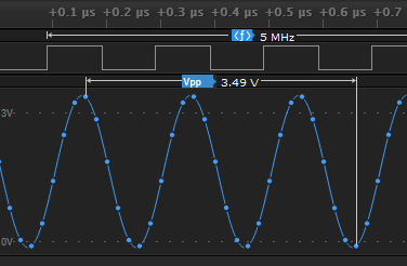

  • Logic Pro 8 or 16: 5 MHz square wave
    Digital Sample Rate: 25 MSPS or greater
    Analog Sample Rate: 50 MSPS (maximum)
    The digital input will show a 5 MHz square wave.
    The analog input will show a 5 MHz sine wave.

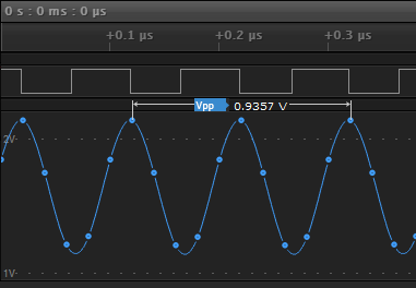

  • Logic Pro 8 or 16: 10 MHz square wave
    Digital Sample Rate: 50 MSPS or greater
    The digital input will show a 10 MHz square wave.
    The analog input will show an attenuated 10 MHz sine wave.
    The peak-to-peak amplitude will be attenuated by the 5 MHz AA filter.

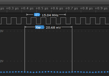

  • Logic Pro 8 or 16: 15 MHz square wave
    Digital Sample Rate: 100 MSPS or greater
    The digital input will show a 15 MHz square wave.
    The analog input will show a flat line.
    Zoomed in, the analog data points will form a highly attenuated 15 MHz sine wave.
