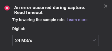

Error Message: ReadTimeout
EditWhen attempting to capture data, you may encounter a ReadTimeout error message: An error occurred during capture: ReadTimeout
Why Does the Error Message Appear?
The Saleae Logic produces data at a fixed rate and can’t tolerate periodic delays between read requests because the device side buffer space is limited. This error message shows up when the device side buffer has run out of memory caused by delays on the USB line during data capture. The Original Logic is the most sensitive to this issue. The newer products (Logic 4, Logic 8, Logic Pro 8, and Logic Pro 16) have significantly larger device side stream buffers and should have no problem with this.

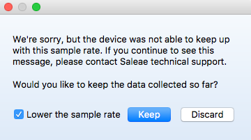

Logic 1.x
If you are using the older Logic 1.x software, the following error message will appear.
We're sorry, but the device was not able to keep up with this sample rate. If you continue to see this message, please contact Saleae technical support. Would you like to keep the data collected so far?
