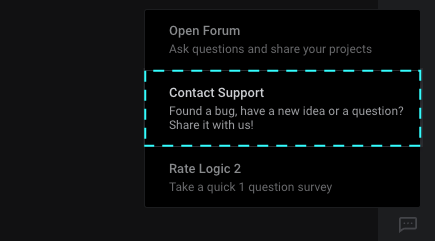

Contact Us From Within the App
If the software can start properly, but crashes during operation, please first ensure that you are using the latest version of the Logic 2 software. If that doesn’t solve the crashes, please feel free to reach out to us from within the app (if the app allows). We will follow up with your request via email.
When contacting us from within the app, we will be interested in the following information.
  • Which product(s) you were using when the software crashed
  • Indicate if this is a new problem or if you have always experienced this problem.
  • Describe what you were doing when the crash/bug occurred. For example, did it occur at the beginning / during / after a capture? Is the crash/bug repeatable? If so, what are the steps leading up to the crash?
  • Include any other relevant information not listed above that might help us uncover the bug. The app allows you to submit a screenshot of the app-view in case that helps.
