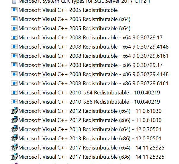

Instructions for Listing All Installed Microsoft Runtimes
  1. Open “Programs and Features” from the control panel or by searching for it on the Start menu.
  2. Scroll down to find one or more items labeled “Microsoft Visual C++ 20XX Redistributable.” Take a screenshot of all the items listed with this name and send it to support.
Example:
