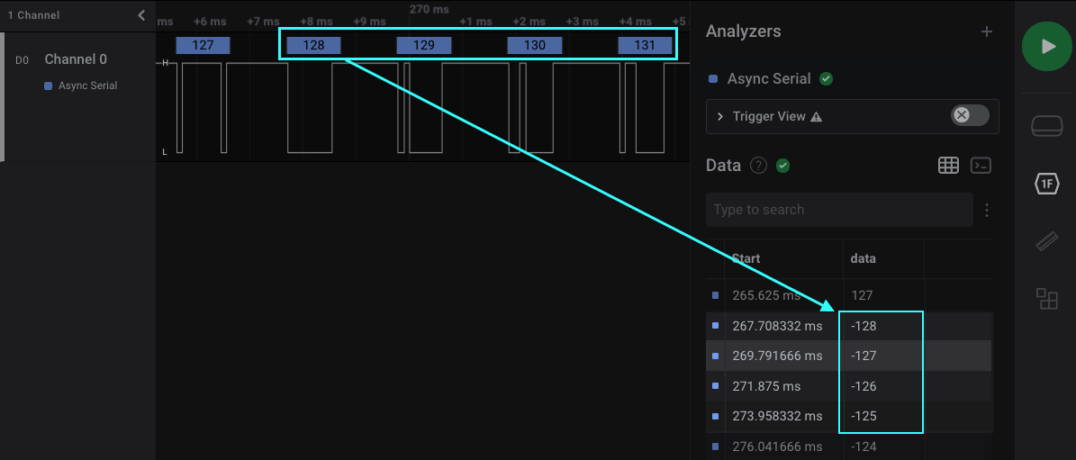

Decimal values appear as signed rather than unsigned
In the image below, you will notice that the Async Serial decoded results above the waveform (unsigned values) do not match the values appearing in the data table (signed values). Our data table unfortunately doesn’t have a schema to tell if a value is signed or unsigned. Everything in the way we handle data tables are all as signed values.
Data Table Values Appear as Signed

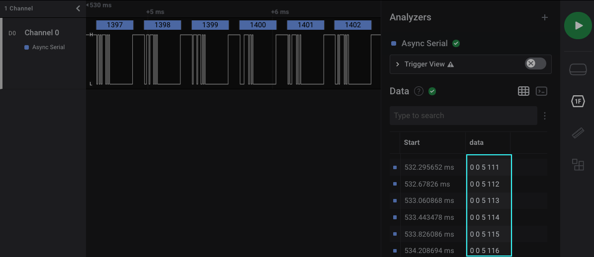

Decimal values appear as an array of values
In the image below, you will notice that the values in the data table appear as a series of array values, rather than a single value that matches the decoded data above the waveform. This happens when the LLA (Async Serial analyzer in the example below) is configured for greater than 8 bits of data.
Data Table Values appear as an Array of Values

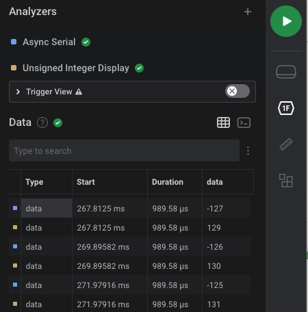

Workaround

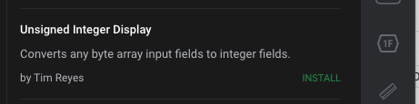

In the meantime (and since we don’t have a native solution implemented), we have published a Marketplace Extension available from within the app called “Unsigned Integer Display.”
Unsigned Integer Display Extension
Instructions to install and use extensions can be found in the links below.
Extension Installation
Create and Use Extensions
When the extension is used, new rows in the data table will be created which contain the values produced by the extension. In cases where the issues above are present, the extension will display the proper values. You may subsequently hide the results of the original LLA (in this case, the incorrect results of the Async Serial analyzer) so that only the correct results from the Unsigned Integer Display extension appear.
Unsigned Integer Display Extension Values in the Data Table
We apologize for the inconvenience this causes in the meantime.
