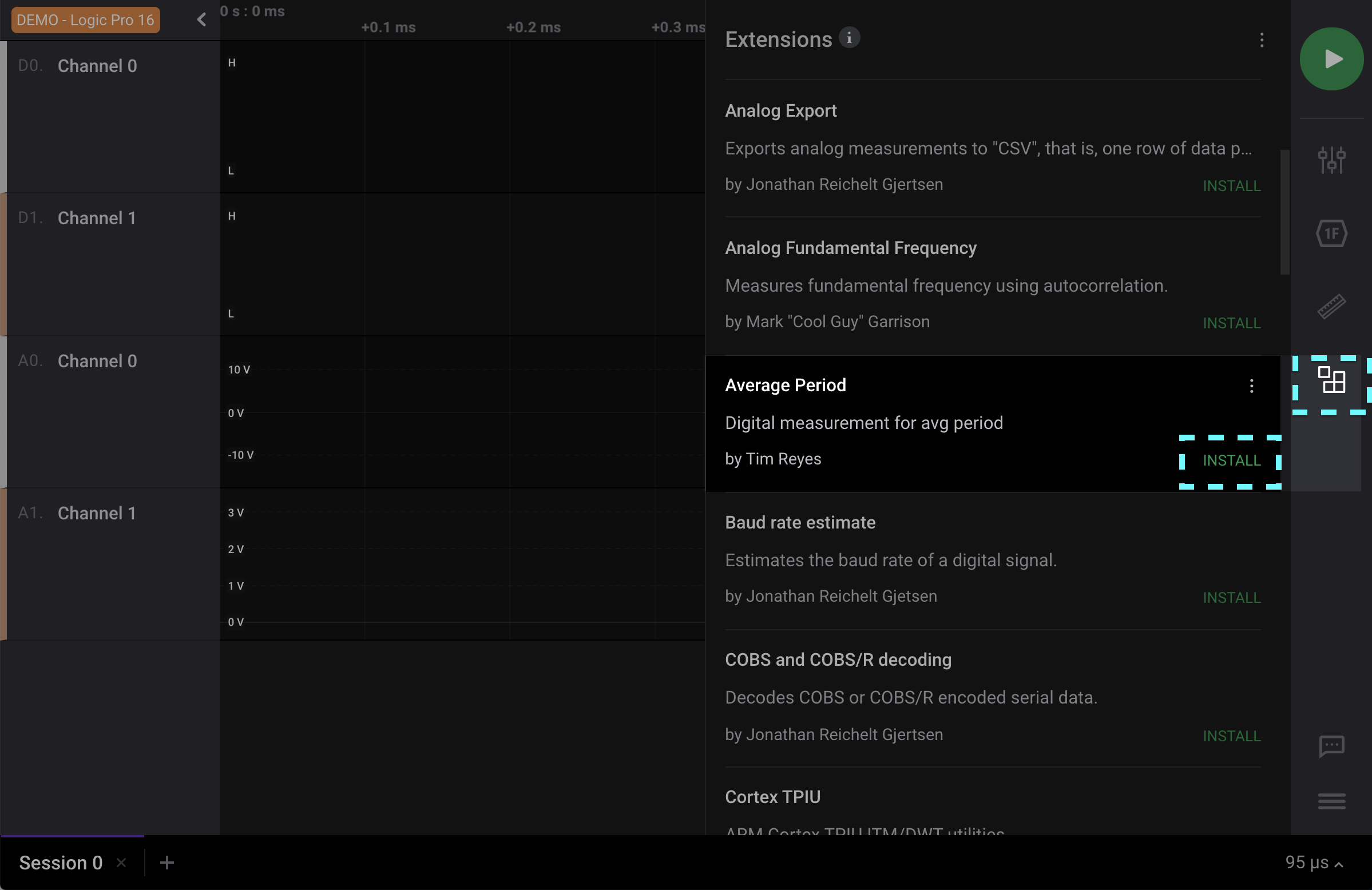

Extension Installation within the Software
This will be the easiest method of installing an extension. Clicking on the Extensions button on the right will open up a list of published extensions from us and from the community. Afterwards, you can click “Install” for the extension of your choice.

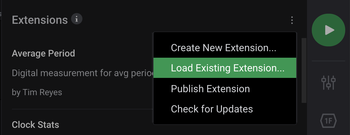

- In the Logic 2 software, on the Extensions panel, click the “three-dots” menu icon, select “Load Existing Extension…” and select the downloaded extension.json file.

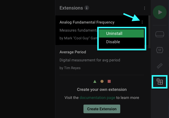

Uninstalling an Extension
To uninstall an extension, click on the 3 dots next to an extension in the Extensions panel. Then click Uninstall.
