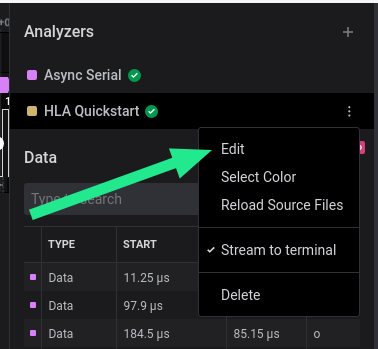

- Use the reload source button in the app to quickly re-run your HLA after editing your source code.

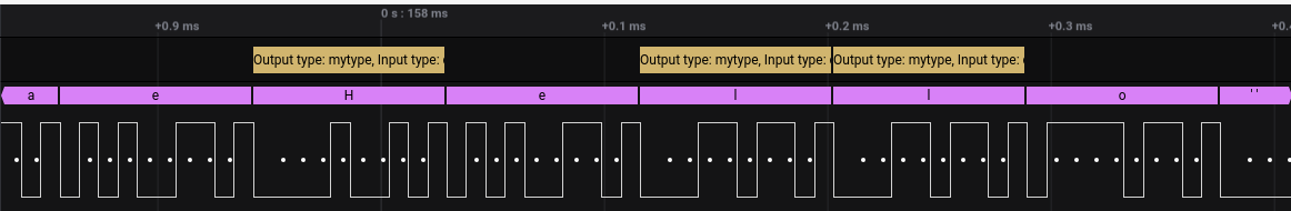

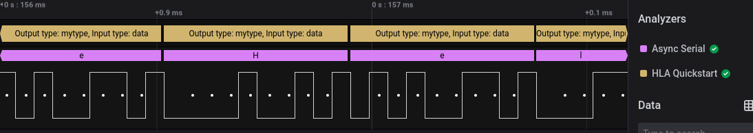

def decode(self, frame: AnalyzerFrame): return AnalyzerFrame('mytype', frame.start_time, frame.end_time, { 'input_type': frame.type })If you open the example data from above and add this analyzer, selecting the Async Serial analyzer as input, you should see the following when zooming in:
Our HLA (top) is outputting a frame for every frame from the input analyzer (bottom), and displaying their types.

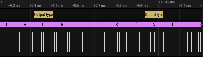

def decode(self, frame: AnalyzerFrame): # The `data` field only contains one byte try: ch = frame.data['data'].decode('ascii') except: # Not an ASCII character return

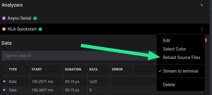

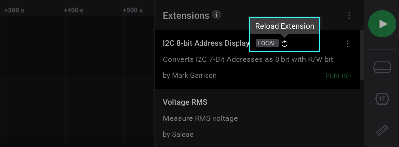

# If ch is 'H' or 'l', output a frame if ch in 'Hl': return AnalyzerFrame('mytype', frame.start_time, frame.end_time, { 'input_type': frame.type })After applying the changes, you can open the menu for your HLA and select Reload Source Files to reload your HLA:
You should now only see HLA frames where the Async Serial frame is an H or l:

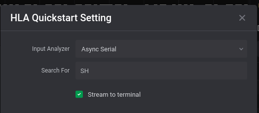

# If the character matches the one we are searching for, output a new frameif ch in self.search_for: return AnalyzerFrame('mytype', frame.start_time, frame.end_time, { 'input_type': frame.type })Now if you can specify the characters to search for in your HLA settings:

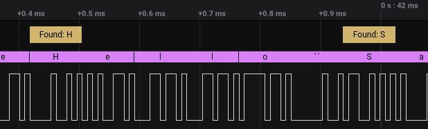

To update the display string shown in the analyzer bubbles, the format string in result_types variable will need to be updated. 'mytype' will also be updated to 'match' to better represent that the frame represents a matched character.
result_types = { 'match': { 'format': 'Found: {{data.char}}' }}And in decode(): we need to update the data in AnalyzerFrame to include 'char', and update the frame 'type' to 'match'.
# If the character matches the one we are searching for, output a new frameif ch in self.search_for: return AnalyzerFrame('match', frame.start_time, frame.end_time, { 'char': ch })After reloading your HLA you should see the new display strings:

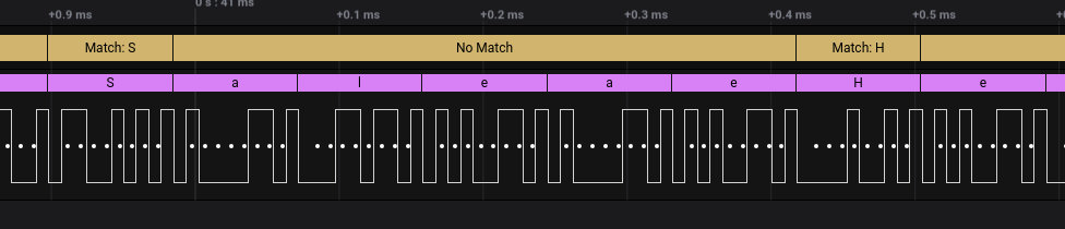

return frameselse: # This frame doesn't match, so let's track when it began, and when it might end if self.no_match_start_time is None: self.no_match_start_time = frame.start_time self.no_match_end_time = frame.end_timeAnd lastly, add an entry in result_types for our new AnalyzerFrame type 'nomatch':
result_types = { 'match': { 'format': 'Match: {{data.char}}' }, 'nomatch': { 'format': 'No Match' } }The final output after reloading:
