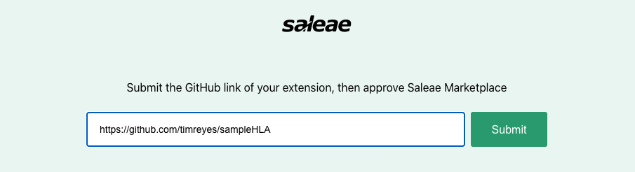

2. Clicking ‘Publish’ should open your browser and load our extensions submission page. Provide your GitHub repository URL here and click ‘Submit’.

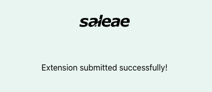

4. Click ‘Authorize’ and you should immediately receive an email confirming that your extension has been added to the Marketplace. The web page should also confirm that your extension was submitted successfully.

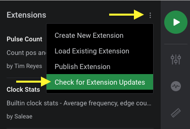

5. Click the three dots at the top of the Extensions panel and click ‘Check for Extension Updates.’

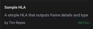

6. Congratulations! If the publish was successful, your extension should now appear in the software like below.
