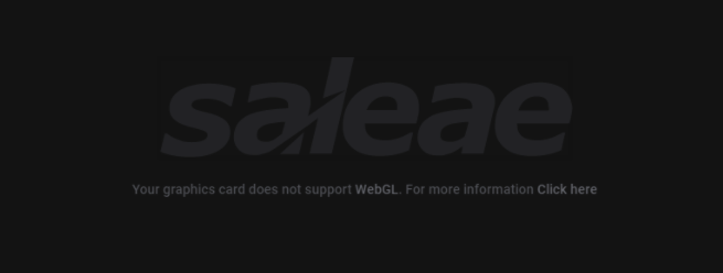

Upon launching the Logic 2 software, you may experience an immediate crash, or an error message may appear, stating either of the following:
  • Your graphics card does not support WebGL.
  • Unable to detect WebGL, please contact support.
Unable to Detect WebGL Error

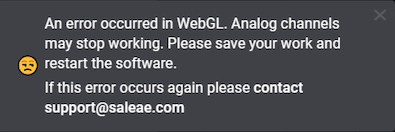

  • An error occurred in WebGL. Analog channels may stop working. Please save your work and restart the software.
WebGL Error Message
