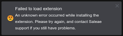

Error Message: Failed to Load Extension
When starting the Logic 2 software, the following error message may appear.
Failed to load extension. An unknown error occurred while installing the extension. Please try again, and contact Saleae support if you still have problems.
Failed to load extension error message
