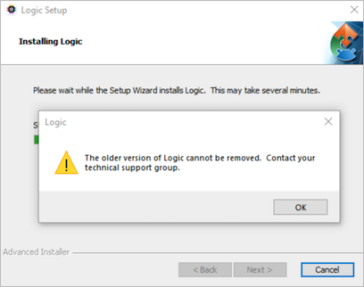

EditThe Older Version of Logic Cannot be Removed
The error message upon installation is likely caused by a missing or mis-referenced uninstaller file location. Unfortunately, we’re unsure of what exactly causes this error, however we’ve detailed a solution below.
Specifically, Microsoft has made available an Install and Uninstall troubleshooter which might help. The troubleshooter should provide steps for you to follow, and you’ll want to locate the our software from the list of available software to uninstall. Once you’ve uninstalled it via this method, you may attempt to re-install the latest version of our Logic software.

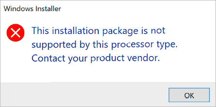

This Installation Package is Not Supported by this Processor Type
Installation error on 32-bit Operating Systems
This error message during installation typically occurs when attempting to install the Logic 2 software on a 32-bit processor or operating system. Please note that 32-bit operating systems are not supported by Logic 2.x. For 32-bit support, please refer to Logic 1.x below.
