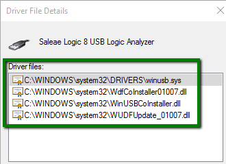

First, connect the Saleae device, while the Saleae software is closed. Second, open device manager, and expand the section “Universal Serial Bus Controllers” Third, locate the Saleae device an double click it to open the device properties. Usually “Saleae Logic X USB Logic Analyzer” (X being the specific product name)
Navigate to the driver tab. Click the button “driver details”
Note the files listed in the “driver files” list.
These four drivers are part of the WinUSB driver, which all Saleae devices use on all versions of Windows. Note that 4 files are listed - if not all 4 drivers are listed, that’s OK.
  • winusb.sys
  • WdfCoInstaller01007.dll
  • WinUSBCoInstaller.dll
  • WUDFUpdate_01007.dll
If any other files are listed, please take a screenshot and send that to Saleae support
Those other files most likely belong to another driver which has attached itself to the Saleae device.
