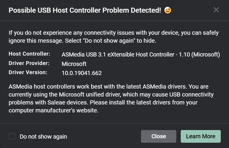

In Windows, the Logic 2 software may generate the following warning message if it detects a possible USB host controller incompatibility.
Possible USB Host Controller Problem Detected! If you do not experience any connectivity issues with your device, you can safely ignore this message. Select “Do not show again” to hide.
This message does not indicate the device is not working. Instead, it simply checks your computer against a known list of USB host controller & driver combinations that customers have reported problems with in the past. If you are not experiencing any connectivity issues, you can safely ignore this message.
ASMedia and VIA Host Controllers
The two known USB host controller driver combinations with problems (ASMedia host controllers and VIA host controllers) both have known working driver configurations.

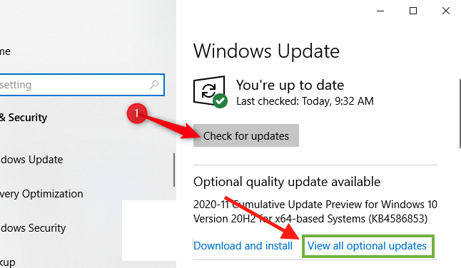

- If there is a driver available for your computer, there is a good chance Windows Update will have it. To check, open Windows Update, and click “View optional updates” and expand “Driver Updates.”
If your driver is not shown in the list of “Driver Updates” in Windows Update, then there is no update available from Windows Update. In this case, you should not attempt to force install one of their update packages.

- We’ve received reports of some issues with the November version of Intel’s USB 3.1 eXtensible Host Controller. Please check Windows Update if it reports any optional updates available for your USB host controller as shown in the image below.
