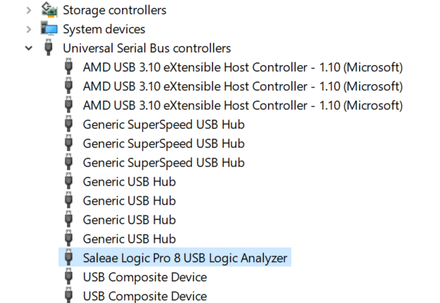

  3. Locate your Logic device under the section “Universal Serial Bus Controllers” in Device Manager
  4. Select your Logic device, so it is highlighted

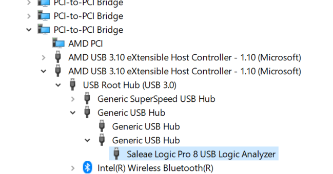

  5. From the view menu, select “View devices by connection (Note, your Logic device needs to be selected when you do this, otherwise it will be lost in the tree view)
    View Devices by connection
  6. The view will transform, but your Logic device should be still selected. Now trace the tree view up to locate the USB eXtensible host controller that is associated with it.
    Locate the USB eXtensible Host Controller Associated with your Logic
  7. Note which host controller it is (USB 3.1 or USB 3.2)

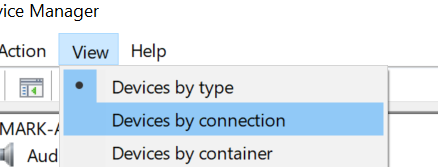

  8. From the view menu, change back to “Devices by type”
