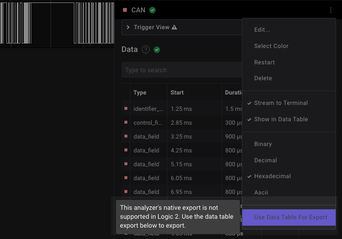

When attempting to export your analyzer’s decoded data, you may notice the following warning pop up.
This analyzer's native export is not supported in Logic 2
Currently, 3 pre-installed analyzers have their built-in exports disabled, and can only be exported from the data table. Namely, these are:
  • MDIO
  • CAN
  • LIN
This is because of a technical limitation caused by Logic 2’s new ability to run protocol analyzers during a looping capture mode. In the looping mode, we delete old data as new data is recorded, and this includes analyzer results. These 3 analyzers can’t export because their export systems can’t handle the data deletion.
Instead, we recommend users use the data table export for all protocol analyzers, as this produces a much more flexible format. More information on data table export can be found below:
