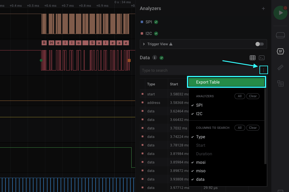

The Logic 2 software allows exporting of the entire Data Table, which can include entries from all of your added analyzers. To export the Data Table, click the 3 dots to the right of “Data,” then click “Export Table.”
Exporting the Data Table

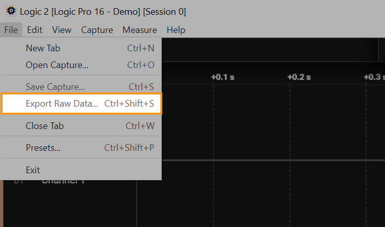

Exporting Raw Data
To export raw data from your capture, click the Options button at the bottom right of the software, then click “Export Raw Data.”
Export Raw Data

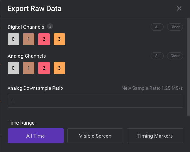

You will be greeted with an “Export Raw Data” window. From here, you can select the channels you would like to include in your export, the analog downsample ratio (if analog channels are included), and the time range.
Export Raw Data Window - 1

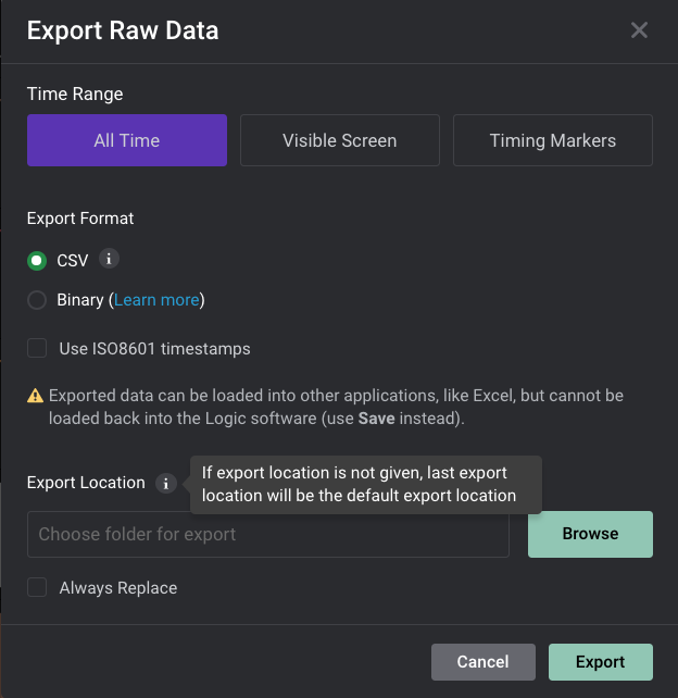

Scrolling down the “Export Raw Data” window reveals more options, including the desired Export Format, as well as the Export Location. An “Always Replace” option is also available to continuously overwrite your previous exported files in the specified Export Location.
Export Raw Data Window - 2

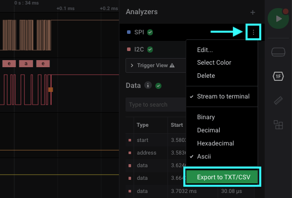

To export your individual analyzer results, click the 3 dots next to the particular analyzer you’d like to export data for. Then click “Export to TXT/CSV.” You will be greeted with an OS prompt to save your export file.
Exporting Analyzer Results
