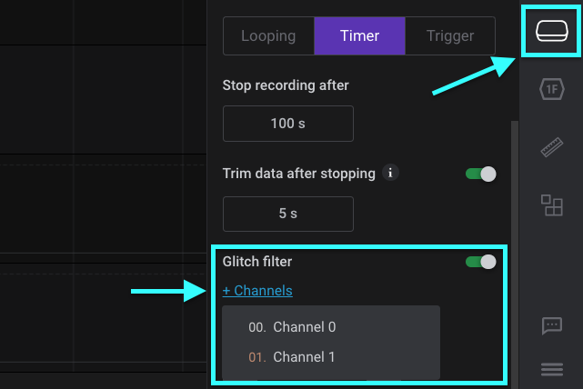

Please note that the glitch filter must be configured before the capture is taken. The glitch filter is considered a pre-capture setting and cannot be modified after the capture is completed.
You can find the glitch filter settings via the ‘Device Settings’ panel button to the right of the software. You will need to click the slider and add the appropriate channels to enable it.

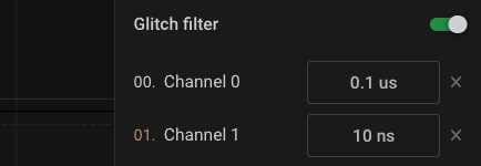

When editing the glitch filter value, you may select a unit of time, such as ns (nanosecond), us (microsecond), and ms (millisecond). You may also use non-integer values.
