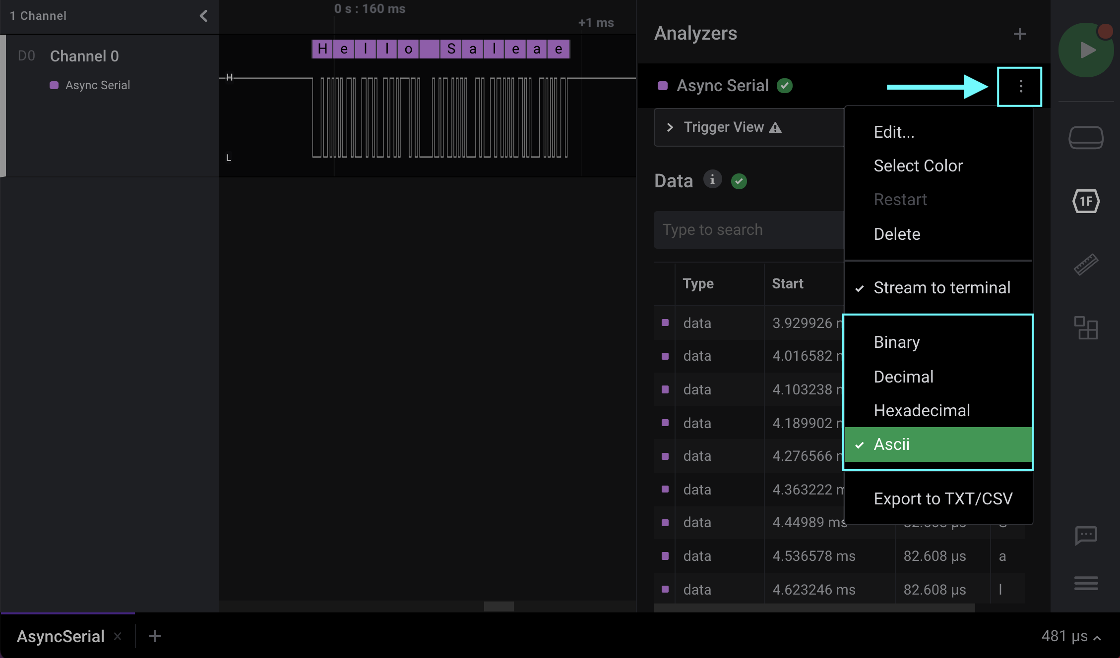

The display radix can be changed for each individual analyzer added to your capture by clicking the three dots to the right of your analyzer as shown below.
Setting the Display Radix for an Individual Analyzer

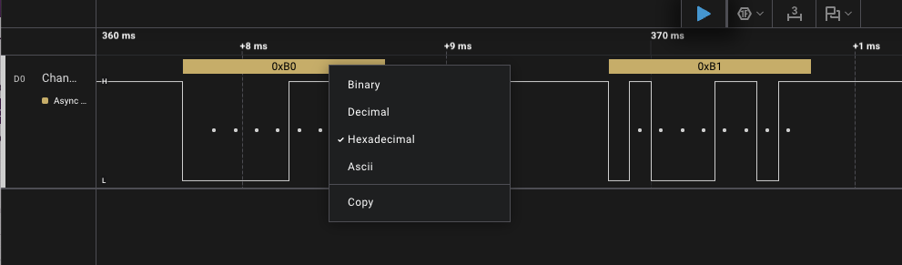

You can also change the display radix by right-clicking on a protocol result above the waveform like in the image below.
Rick-clicking an analyzer result to change the display radix
