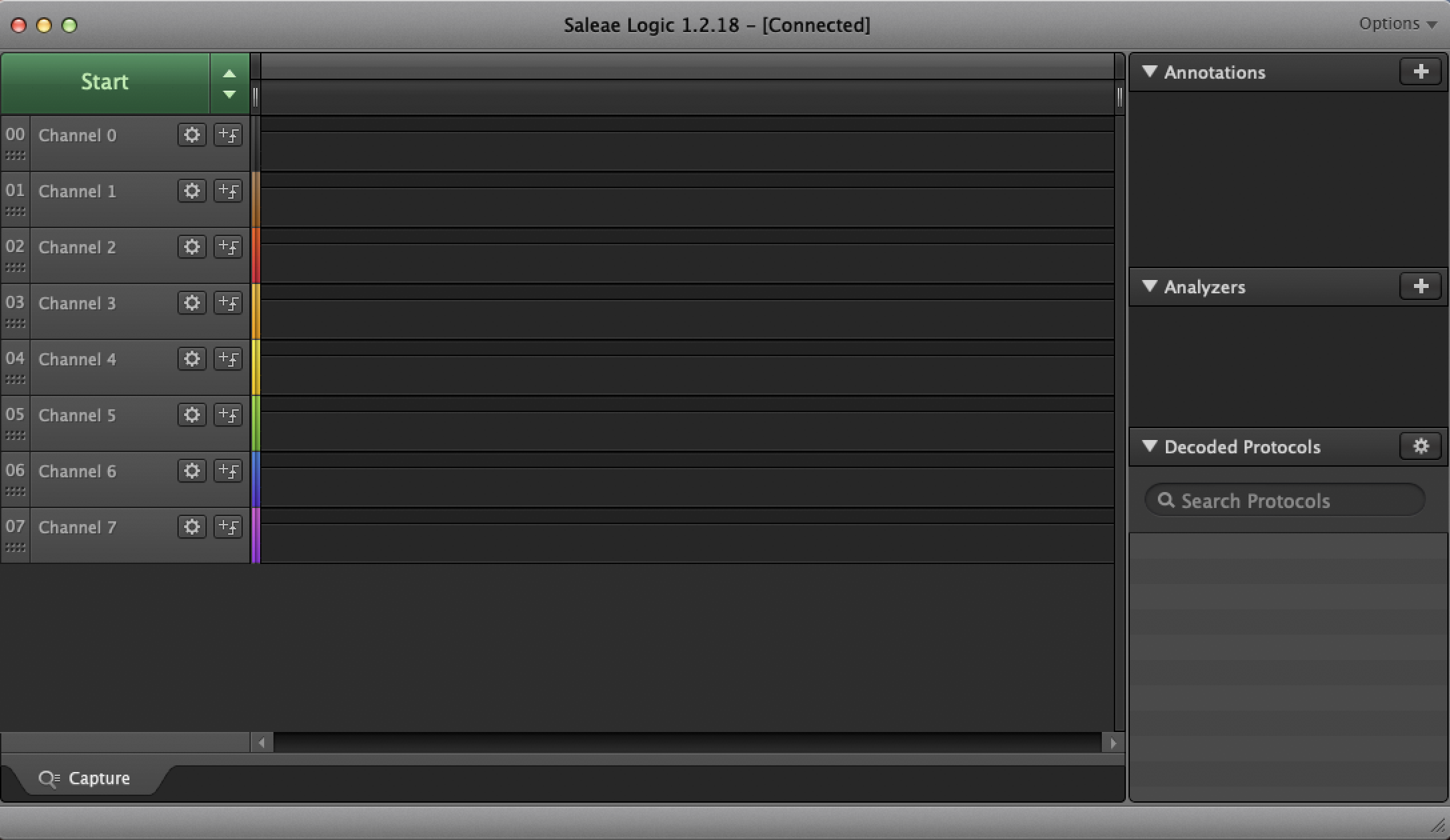

Installing for Mac
Simply download, double-click, and drag the Logic software into the Application folder. It is the same as other Mac software you have installed in the past.
