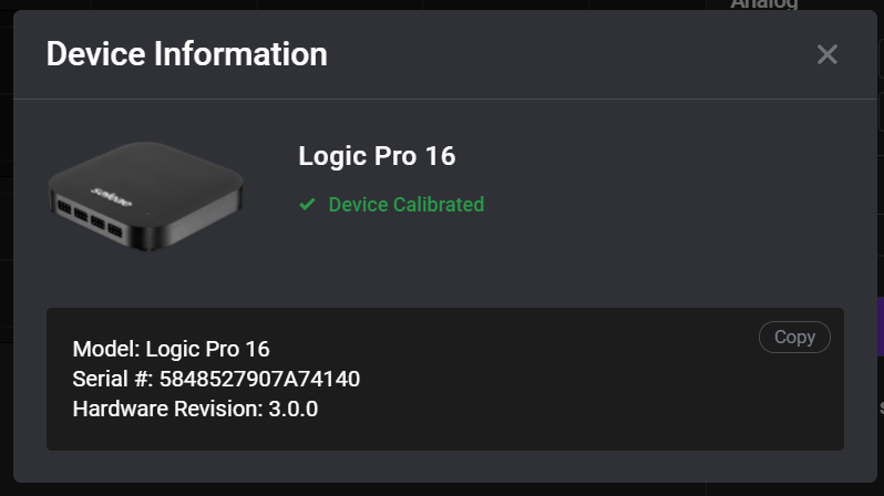

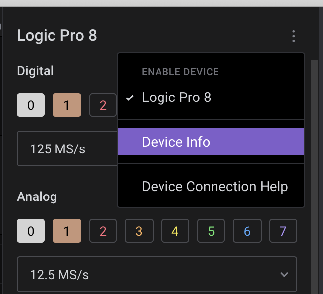

Checking your Device’s Hardware Revision
To check your hardware revision, you will need the latest version of the software available here.
  1. Connect your Saleae device
  2. Open the device info dialog
  3. Check the hardware revision
The Device Info dialog is opened from the capture settings sidebar menu
The hardware revision is shown in the last line
