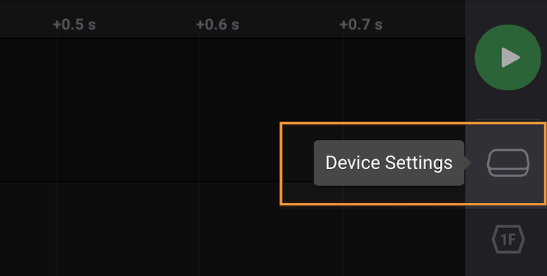

The Device Settings Panel can be opened up by clicking on the Device Settings icon located on the software’s side panel on the right.
Device Settings Button

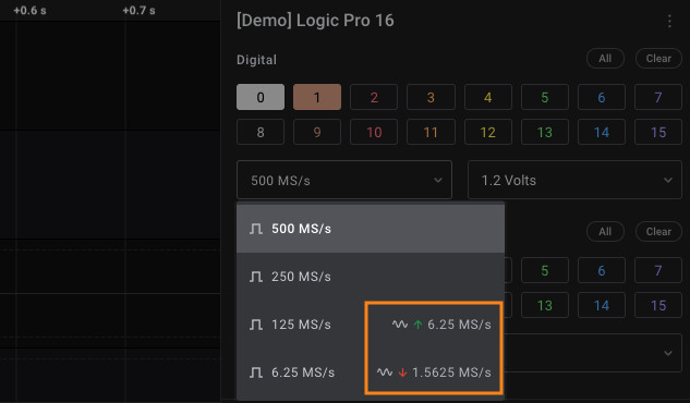

Please note that changing these settings may affect the available sampling rates for other channels. This is due to the total amount of available bandwidth that our logic analyzers can support. When this happens, you will receive a popup about the sampling rate change like shown below.
Sampling Rate Change Popup Warning
When both digital and analog channels are enabled, changing the sampling rate for a certain type of channel (digital or analog), may also change the sampling rate for the other type (digital or analog). This is because certain digital sampling rate selections cannot be combined with certain analog sampling rates (and vice versa) due to architectural limitations.
In the example image below, selecting Digital 125 MS/s will increase () the Analog sampling rate to 6.25 MS/s from its current setting. In addition, selecting Digital 6.25 MS/s will decrease () the Analog sampling rate to 1.5625 MS/s from its current setting.
Digital Sampling Rate Selections may Change the Analog Sampling Rate
