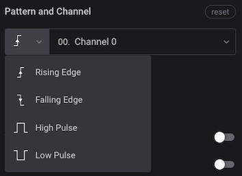

Edge & Pulse Triggering
The trigger mode will continuously record data until a digital trigger is found on a single channel. The four available types of digital triggers are Rising Edge, Falling Edge, High Pulse, and Low Pulse.
Trigger Mode Capture Settings

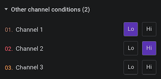

Additional Channel State Triggering
In addition to the edge/pulse trigger which is set on a single digital channel, you can require other digital channels to be either HIGH or LOW to trigger a capture.
Digital Channel State Conditions for Trigger

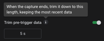

Capture Duration Before and After Trigger
The data that was captured before the trigger can be trimmed down in length. This allows you to specify how much of the data before the trigger is kept when the capture ends.
Trim pre-trigger data

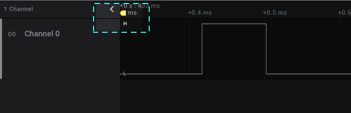

  • Via clicking on the trigger icon above your capture (shown below)
Clicking on the Trigger icon will jump the view to the trigger point
At the moment, we don’t have a way of automatically jumping to trigger point after a capture. If this is a feature you would like added, please vote for it in the idea post here!

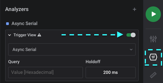

Trigger View - Triggering on a Protocol Result
Navigate to the “Analyzers” panel and enable “Trigger View.” From there, select the protocol analyzer you would like to trigger on, as well as the query value and holdoff time. HLA results can also be triggered on via this method.
Please note that Trigger View is only supported for the analyzers listed in the support article link below (Titled HLA - Analyzer Frame Format). This means that custom analyzers, including pre-installed analyzers that are not listed, will not work with Trigger View.
This is due to our Trigger View relying on a new low level analyzer framing format that we call “frame v2.” Only a handful of analyzers support “frame v2” at the moment, and these are the analyzers that work with Trigger View. We eventually want to extend Trigger View support to all analyzers in the future. Feel free to vote on this feature request here!

Trigger View - SPI Example
Triggering on a protocol frame
