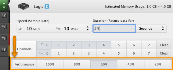

Digital and Analog Captures
When capturing both digital and analog channels in the same capture, the selection of the sampling rate combination does not change the USB bandwidth usage of Logic. In order to reduce Logic’s USB bandwidth usage in this case, you will need to lower the Performance percentage setting. This will decrease speeds of the available sampling rate combinations, and therefore, also decreases the memory usage of captures.
