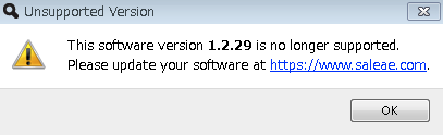

Warning Message: Unsupported Version
EditUpon opening the Logic 1.x software, you may be prompted with the following warning message. Unfortunately, we’ve also seen cases where this message may cause the software to crash upon closing it.
This software version is no longer supported. Please update your software at www.saleae.com.

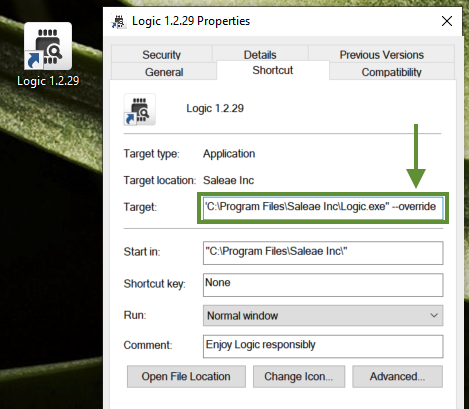

Bypassing the Warning Message
You can bypass this warning message by adding an override launch argument.
In Windows, you can add the --override launch argument by right-clicking the shortcut and opening the Properties window as shown below.
