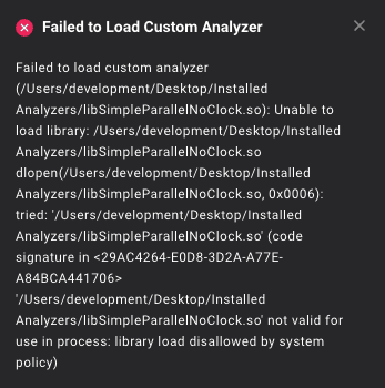

Attempting to Load a .so File (Instead of a .dylib File)
Some custom analyzer repositories may provide the MacOS analyzer library file as a .so file (rather than a .dylib file). If so, you may be greeted with the following error pop up upon attempting to load the analyzer. The fix for this is described in the steps below.
Failed to Load a .so file

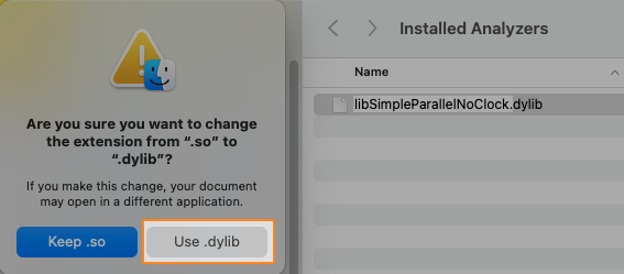

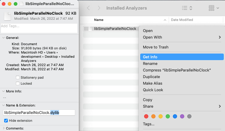

  1. Update the file extension to a .dylib file. To do this, right click the .so file, click “Get Info”, then change the file extension type to .dylib like shown below. When the confirmation pop-up window to change the file type appears, click “Use .dylib”.
    Change file extension type to .dylib
    Click "Use .dylib"

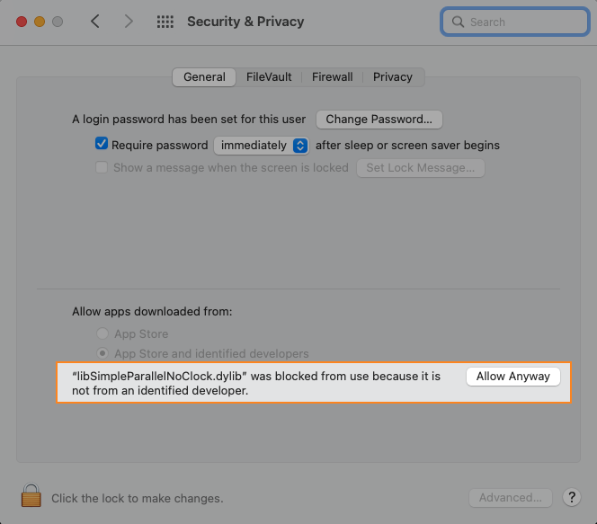

  2. Upon loading your new .dylib file into the Logic 2 app, you may be greeted with a new security error from MacOS like shown below.
    .dylib file cannot be verified by MacOS
    To get around this error, you will need to allow this file through MacOS’s security. Navigate to MacOS’s System Preferences, and select Security & Privacy. Under the “Allow apps downloaded from…” section, select “Allow Anyway next to the .dylib file that was recently blocked by MacOS.

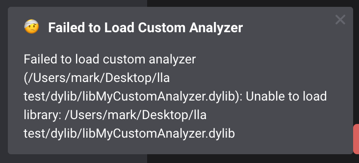

When first attempting to import a custom analyzer that was originally built for Logic 1.x, you may be greeted with a “Failed to Load Custom Analyzer” error like below. The solution for this is described in the steps below, which will change how the custom analyzer library locates the libAnalyzer.dylib library, which has a different relative path than the older Logic 1.x software.
Failed to load custom analyzer…
Unable to load library…
Initial Error upon Loading LLA on MacOS
  1. Open the Terminal (open Spotlight -> search “Terminal” -> press enter)
  2. navigate to the directory containing your custom analyzer (e.g. cd ~/Downloads/mylla)
  3. run the following command, replacing libYourCustomAnalyzer.dylib with your analyzer’s file name:
    install_name_tool -change @executable_path/libAnalyzer.dylib @rpath/libAnalyzer.dylib libYourCustomAnalyzer.dylib
  4. close the terminal, and open the Logic 2 application again.

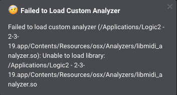

When attempting to run the Logic 2 software on MacOS, the following error message may appear.
Failed to load custom analyzer (/Applications/Logic2-x-x-xx.app/Contents/Resources/osx/Analyzer/libmidi_analyzer.so): Unable to load library
Failed to load midi analyzer
The workaround we’ve found is to update to the latest version of MacOS, since our build system for Logic 2 typically targets that. When running an older version of MacOS, the error message above may appear.
If you require using an older MacOS version and cannot update for whatever reason, you may delete libmidi_analyzer.so from the specified folder to get rid of the error message. This just means that you cannot use the pre-installed MIDI protocol analyzer. So long as you don’t plan on analyzing MIDI data, this is OK to do.
