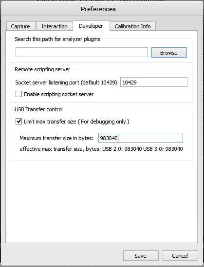

Set the maximum transfer size to about 60 URBs worth, 16102460 bytes = 983040 bytes.
To do so, open the preferences dialog from the main options menu and navigate to the developer tab. Check the box to limit the max transfer size and then enter the new maximum transfer size in bytes.
Then perform a series of test captures at different sample rates, digital only. Please test a good spread between 1 channel at 1 MSPS to all 4 channels at 500 MSPS. Make sure to include testing 1 channel at 500 MSPS, then 2 channels, and then 3 channels.

If you were instructed to set the transfer size to a specific number, you can do so by opening the preferences dialog from the main options menu and navigating to the developer tab. Then check the box to limit the max transfer size and enter the specified size into the text box.
