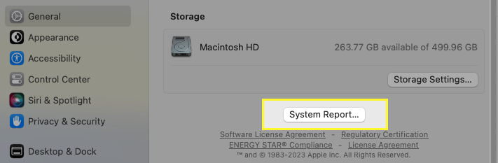

Next, open “System Report” by opening the Apple menu and selecting “About this Mac,” and then select “More Info…” Afterwards, scroll down and select “System Report…” In the new window, select Hardware > USB. It’s important to connect your Logic analyzer first before opening “System Report”, since “System Report” may not dynamically update it’s list of connected device if a USB device is connected while it’s open.
Please make sure the Logic Software is not running running when checking this. Otherwise, the device will not appear with the relevant information we are looking for.
System Settings > About > General window

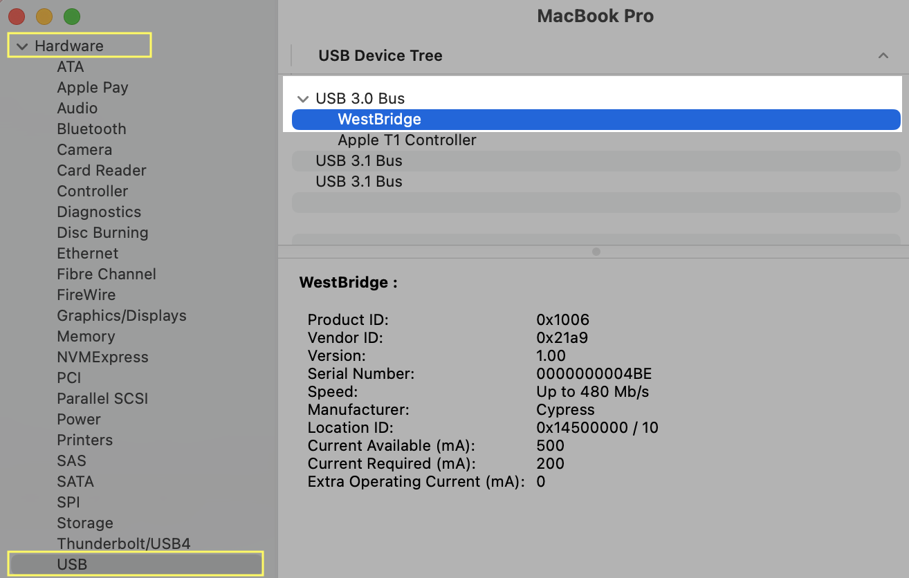

On Intel-based Macbooks, a “Westbridge” device should be listed in the USB Device Tree like in the image below.
System Report on Intel-Based Macbooks

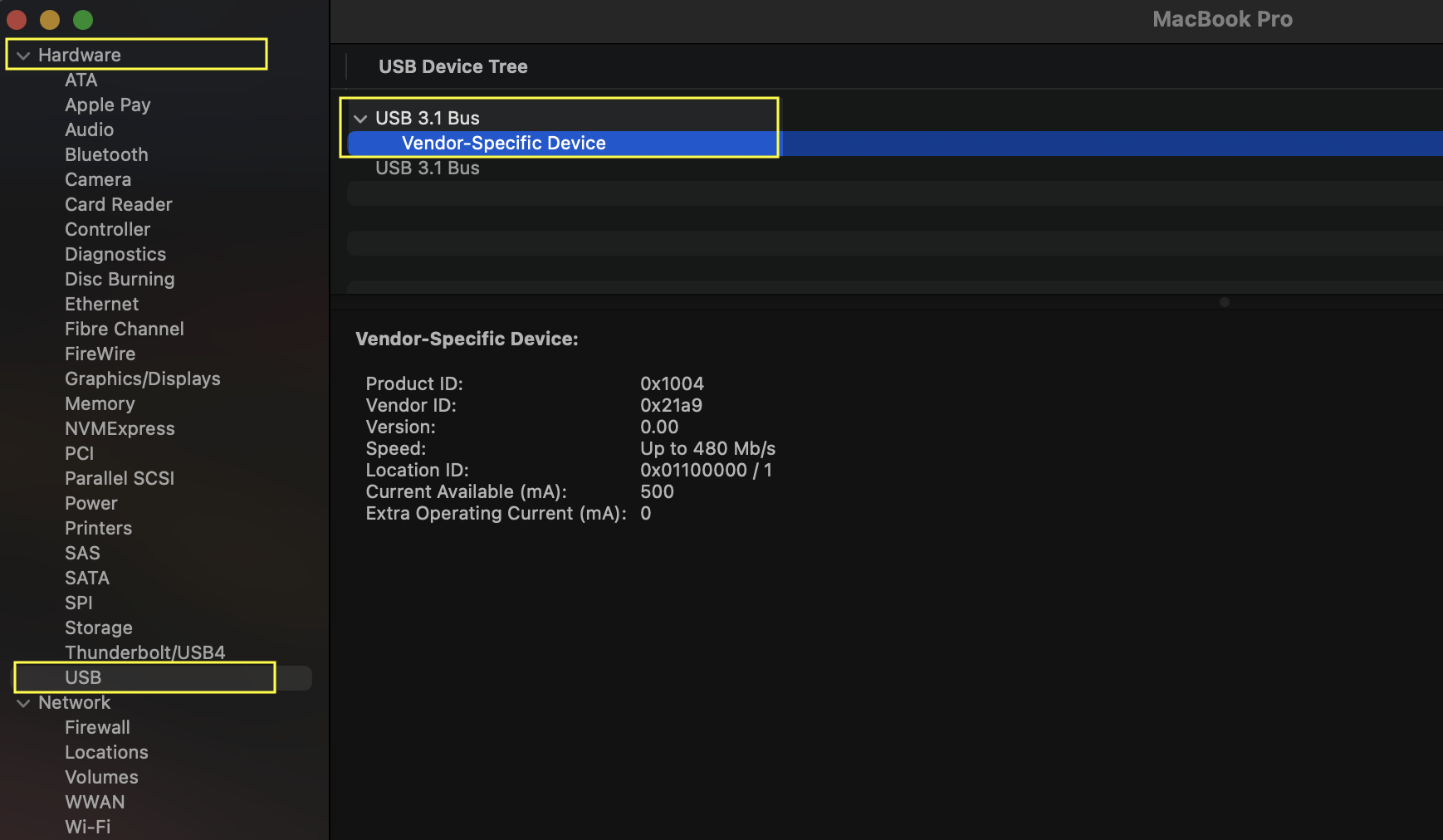

On Apple-silicon based Macbooks, a “Vender-Specific Device” should be listed in the USB Device Tree like in the image below.
System Report on Apple-Based Macbooks

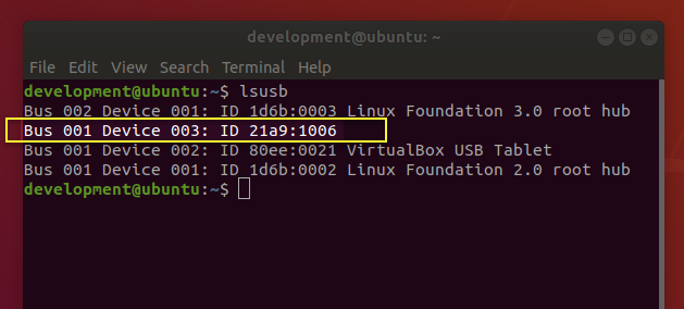

Run lsusb from the command line. Check for any device name containing “Saleae” or a VID and PID that matches one of our Logic products. You can refer to the VID/PIDs of our devices in the support article below for reference.
Device USB VID and PID Information
Linux Terminal - lsusb
