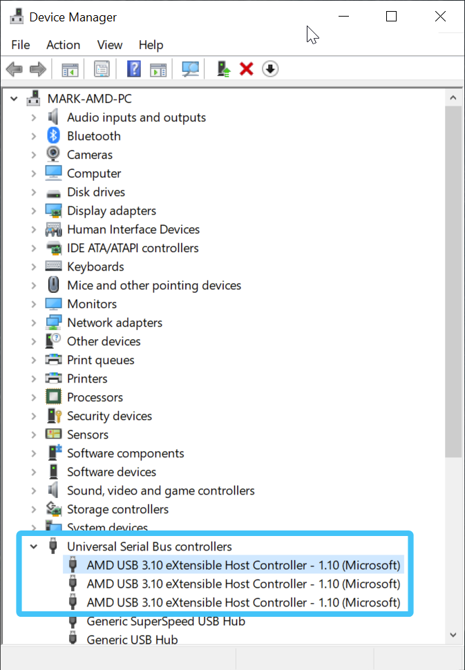

  • Open the device manager by searching the start menu for device manager.
  • Expand the section called “Universal Serial Bus Controllers”
  • Locate your USB 3.0 host controller(s).
    • Names usually include the words “host controller”, “USB 3”, “USB 3.1”, “USB 3.2”, and/or “Extensible”.
    • Examples:
      • AMD USB 3.0 eXtensible Host Controller - 1.10 (Microsoft)
      • Intel(R) USB 3.1 eXtensible Host Controller - 1.10 (Microsoft)
    • There are usually 1 to 3 of these listed.

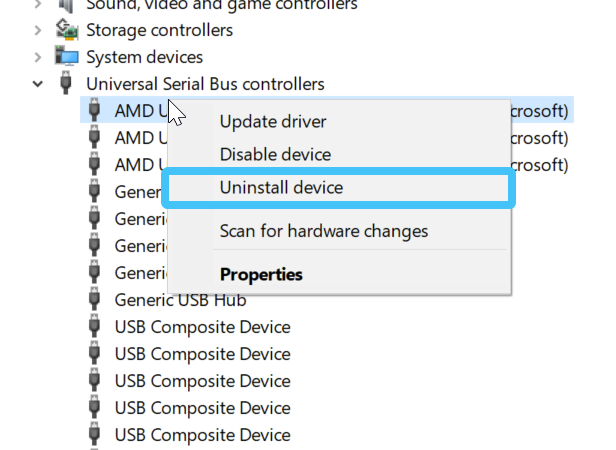

Step 2: Uninstall each USB 3.0 Host Controller
  • Right click each host controller and select “Uninstall Device”.

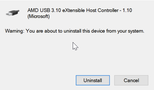

  • Click “uninstall” on the prompt.
  • Repeat this for each USB 3.0 host controller.
