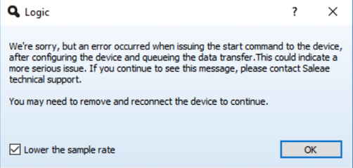

Logic 1.x
In our older Logic 1.x software, the error message will appear as below.
“We’re sorry, but an error occurred when issuing the start command to the device, after configuring the device and queueing the data transfer. This could indicate a more serious issue. If you continue to see this message, please contact Saleae technical support. You may need to remove and reconnect the device to continue”
Error when issuing the start command
As mentioned in the DeviceSetupFailure section above shown in the Logic 2 software, Etron USB host controllers may be the cause of the issue. You can check your USB host controller information from within the Logic 1.x software by following the instructions in the support article below.
