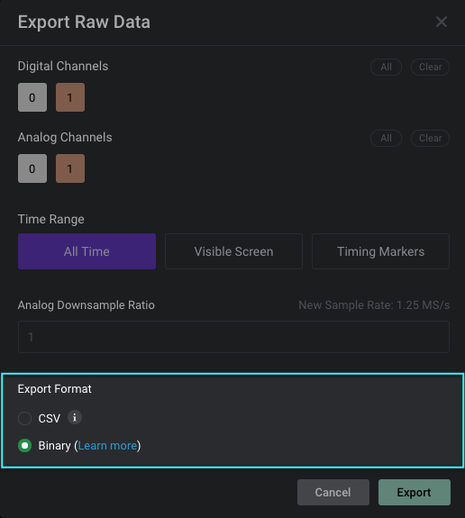

Exporting via Binary File - A Much Faster Approach
An alternative approach (much faster and produces a smaller file) would be to export to a binary file. More details on the binary file format can be found in the link below.
Binary Export Format - Version 0
Exporting to a Binary File
