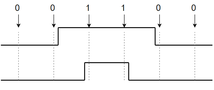

The second error (uncertainty) source is from asynchronous sampling.
In the picture below, the arrows indicate when the logic analyzer is sampling the signal. The two waveforms show the two extreme cases in which the logic analyzer will report the same pulse width.
This is a total error (uncertainty) of 2 sample periods, or +/- 1 sample period.
