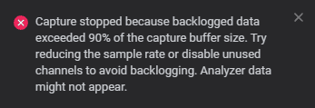

EditWhen capturing data, you may encounter a backlog error message like shown below:
Capture stopped because backlogged data exceeded 90% of the capture buffer size. Try reducing the sample rate or disable unused channels to avoid backlogging. Analyzer data might not appear.
