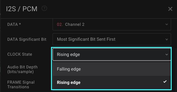

Analyer Result displays “Error: bits don’t divide evenly between subframes”
The analyzer result may also not display the data correctly. An image of the error is provided below.
In the image above, the data bits are transitioning during the clock falling edge, but the I2S/PCM Analyzer is also set to read on the clock falling edge as shown by the “down” arrows on the clock signal.
That means the bits are being decoded at the exact moment the bits are changing, which will cause errors and will be very sensitive to changes in the sample rate. Change the I2S/PCM Analyzer setting for CLOCK State to either Rising edge or Falling edge depending on the correct clock edge that your data requires.
CLOCK State Rising Edge and Falling Edge setting
