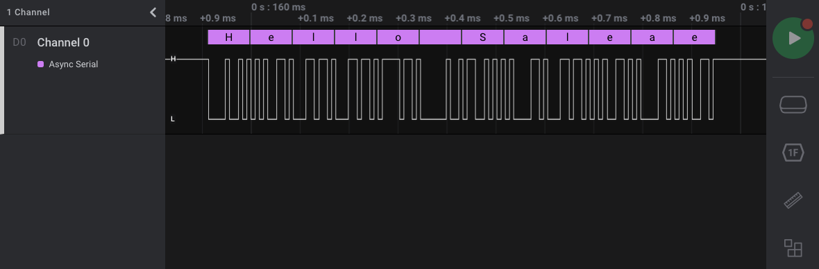

Async Serial Decoding in the Logic 2 Software
Async serial communication is a very generic term that means any data that is transmitted serially (i.e., one bit at a time). The serial analyzer in the Saleae software is flexible, but it’s ultimately designed to only decode serial data that uses the standard start bit and stop bit format. Many other features of the serial analyzer are flexible, though.

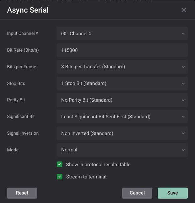

Analyzer Settings
Below is a description of each setting and what it does.
Input Channel
  • Select which channel in your capture you would like to decode.
  • Looking to decode more than one channel? Just add a second serial analyzer!
Bit Rate (Bits/s)
  • This is the bit rate, or baud rate. If you don’t know the bit rate, you can measure it manually. More information on this is described below.
Bits per Frame
This is the number of bits per word (default is “8 Bits per Transfer”). Note that this number is just the data payload and does not include the start, stop, or parity bits.
Stop Bits
The async serial analyzer lets you select 1 stop bit, 1.5 stop bits, or 2 stop bits. The most commonly used setting is 1 stop bit.
Parity Bit

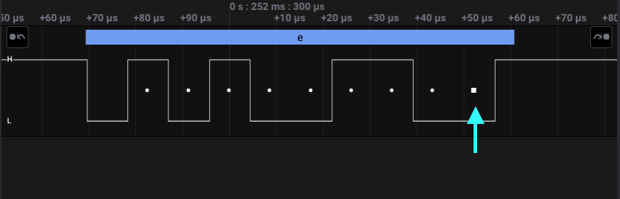

Parity is a feature where the serial transmitter includes an extra bit of information after transmitting the data word but before the stop bit that helps the receiver detect possible bit errors caused by line noise. In Logic software, the parity bit is signified by the bolded square dot, as shown in the figure below.
Example of Even Parity bit, signified by the bolded square dot
  • No parity means no extra bit is transmitted.
  • Even parity means that the total number of binary ones in the data word, including the parity bit, is an even number. For instance, 0b10110101 would have an even parity bit of one because there is an odd number of ones in the data word. An extra one will make the total an even 6 ones.
  • Odd parity is similar to even parity, but the parity bit is used to make the total number of ones in the data word + parity bit and odd number.
Significant Bit
This simply states the order of bits on the bus, just like reading from left to right or right to left.
Signal Inversion
This is an important setting. Usually, TTL/CMOS level serial is active low, meaning that the bus idles high. Binary zeros are transmitted by pulling the line low, and binary ones are transmitted by pulling the line high. That is pretty common.
However, in some cases, such as recording RS-232 serial directly, the states are reversed. In RS-232, the line is idle low, and zeros are transmitted by pulling the line high. When recording RS-232 level signals directly, or in any other case where the channel is inverted, use this option.
Mode
  • MP Mode (also called multiprocessor mode, multi-drop, or 9-bit serial) is a version of serial where the most significant data bit (almost always the last bit) indicates if the preceding 8 bits is data or an address.
  • MDB Mode, also called multidrop bus, is basically the same as MP mode, but the address indicator bit is inverted.
In either mode, the normal serial word (usually 8 bits) is proceeded with an extra bit to distinguish address from data. In MP mode, the extra bit is set to indicate data and clear to indicate an address. The bit state is the inverse for MDB mode.

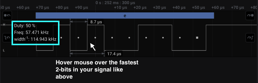

Hover your mouse over the fastest 2-bits, and then take the inverse. One way to do this is to find a 2 bits of data that are opposite in state so you can measure the distance between the two transitions and take the inverse of that measurement to get its bit rate.

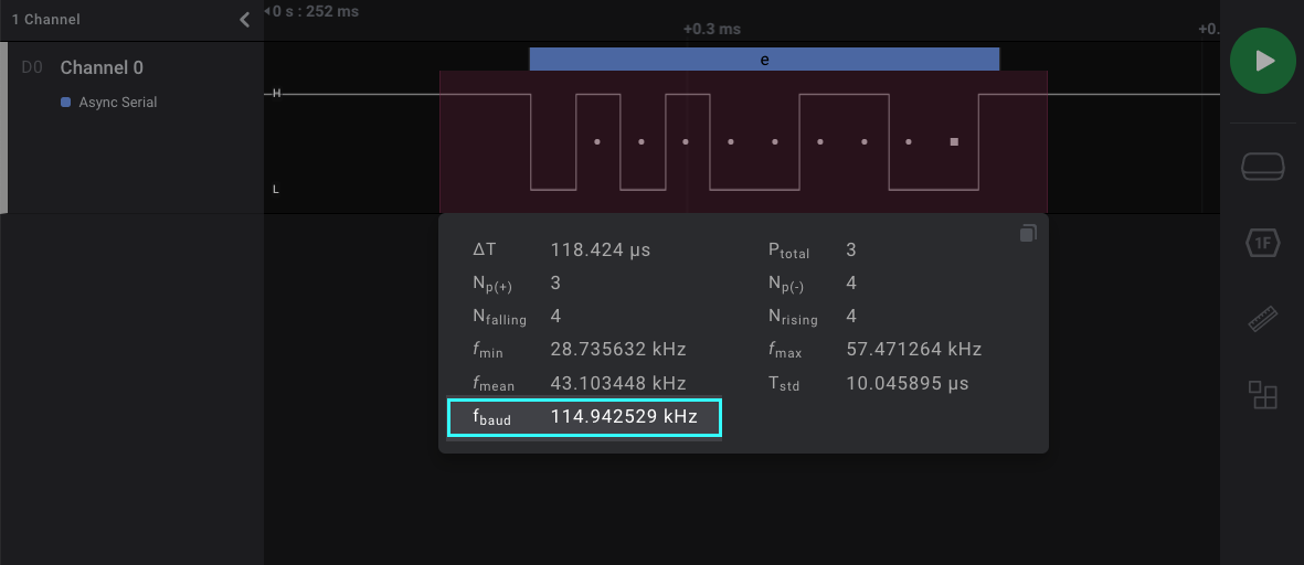

Method 1: Manual Measurement
The software will show auto-measurements like shown in the image below. In this case, the inverse measurement is shown to be 114.943 kHz, which is close to the bit rate of 115.200 kBits/s that the DUT was communicating at.
Measuring the bit rate from your signal via inverse width measurement
It’s best to perform the measurement in several different spots and average the results.

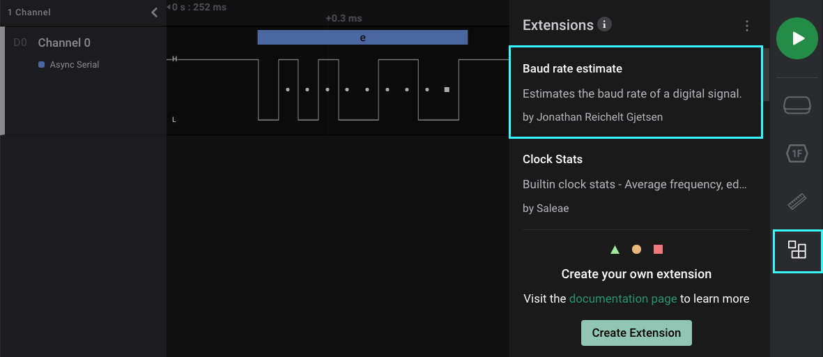

Method 2: Baud Rate Estimate Extension
As an alternative, you may also use a Baud Rate Estimate extension that was developed and kindly shared by a community user. The extension is available on our Extensions Marketplace.
Baud Rate Estimate metrics as shown by a measurement box

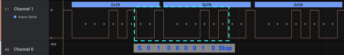

  • Decoded data may be offset if there are no gaps between data transactions. An example of this issue is shown in the image below. This is especially apparent when the Logic capture is started in the middle of data transmission. The workarounds would be as follows:
    • Make sure to start your capture before serial data transmission has begun.
    • Ensure that your transmitted data contains idle periods of at least 1 transaction wide. Our Async Serial will always resync on the next set of data after the idle period of 1 transaction wide.
Decoded Data is Offset
