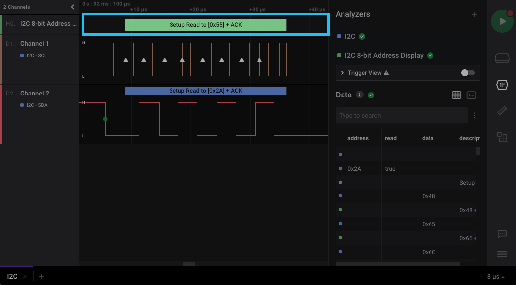

In certain scenarios, it may be preferred to view the address field as an 8-bit value (incorporating the R/W bit). We’ve added a high level analyzer (HLA) extension that allows for this feature.

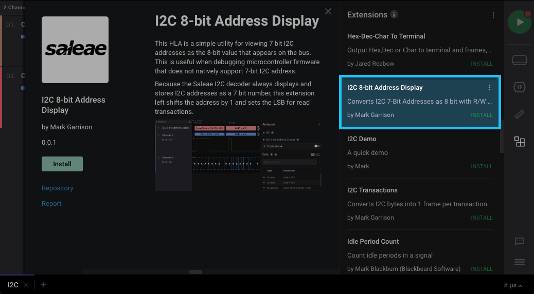

1. Navigate to the Extensions panel of the software on the right
2. Find the “I2C 8-Bit Address Display extension” and click Install

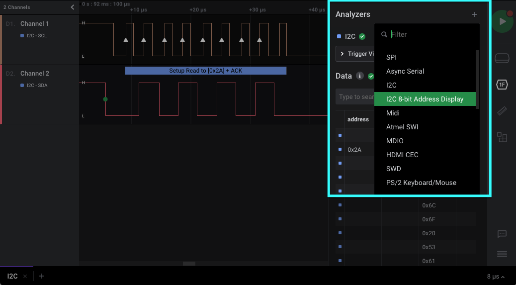

3. Once installed, navigate to the Analyzers panel on the right and add it as an analyzer by clicking the ”+” button.
4. When the setup window appears, select your I2C analyzer
5. Afterwards, your I2C addresses should appear as an 8-bit value as shown below.
