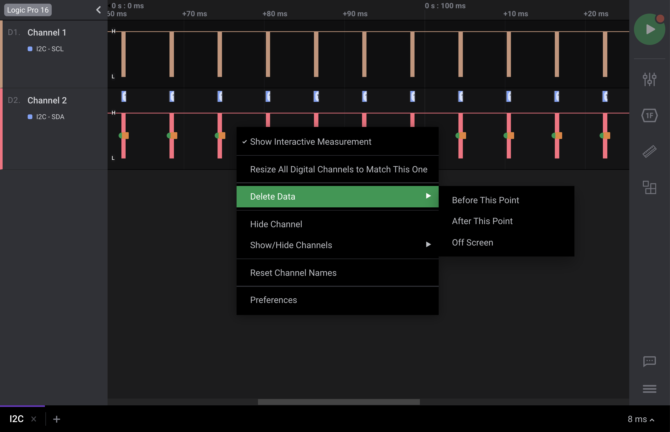

Right-Click in the Waveform
Right-clicking any point in your capture will show the option to “Delete Data.” You can delete the data before this point, after this point, or all the data off-screen.
