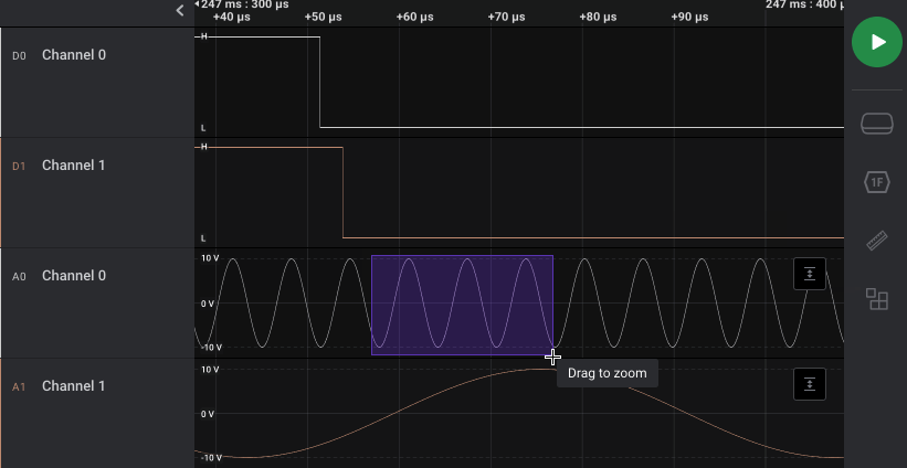

Marquee Zoom: Zooming by Drag Select
Marquee zoom (i.e. zooming in by drag-selecting a region of the waveform) is available on analog channels.
- Use
Alt-Dragfor XY Range Zoom Ctrl-Drag Up/Downfor Y (Voltage) Range ZoomCtrl-Drag Left/Rightfor X (Time) Range Zoom

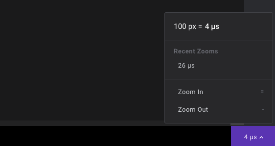

X-Axis Discrete Zoom Level
In addition to using the keyboard shortcuts described above for zooming in and zooming out, the Logic 2 software allows you to set a discrete zoom level. The setting for this is located at the bottom-right of the software as shown in the image below.

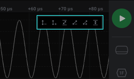

Y-Axis Zoom for Analog Channels
The Y-axis zoom level for analog channels can be adjusted by hovering over the icon shown in the image below. It will appear at the top-right of an analog channel when hovering over that channel.
While hovering over the icon, several Y-axis zoom adjustment options become available as shown in the image below. These include:
- Y zoom-out / zoom-in / Y fit
- XY zoom-out / zoom-in / XY fit
