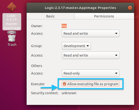

The Logic 2 software is provided in an AppImage format, which contains all the files needed for the software to run. In Linux, you may need to allow executing the file as a program. To do this:
1. Right-click the AppImage file and click Properties
2. Check the box that says “Allow executing file as program” as shown in the image below.
3. Alternatively, you can run the following command to allow exectuing the file as a program.
chmod +x Logic-2.x.xx-master.AppImage
4. Once the file is allowed to execute as a program, simply double-click the AppImage file to launch the software, or run it from the command line.
./Logic-2.x.xx-master.AppImage

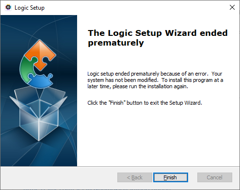

Windows Install Errors
In case you run into any installation issues, please refer to the support article below.
