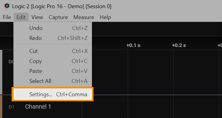

First, click the Settings button to open the Settings window.
  • On Windows: Edit > Settings
  • On MacOS: Logic2 > Settings
  • On Ubuntu: Edit > Settings
Settings Menu

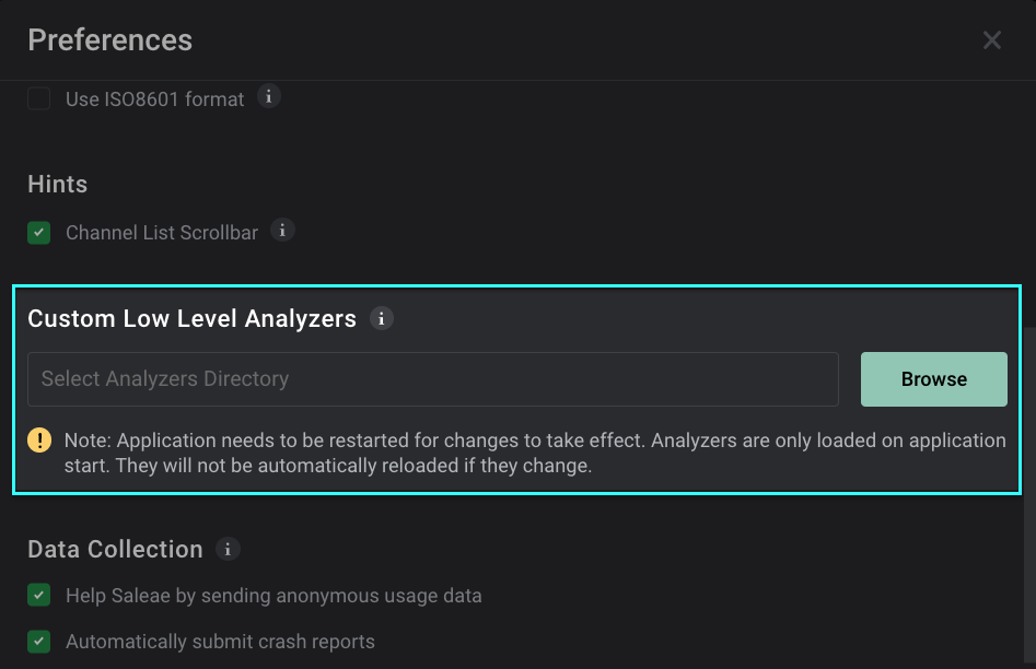

Then, in the Settings window, scroll to the bottom until you reach the Custom Low Level Analyzers section.
Custom Low Level Analyzers Directory Location
Click the browse button to select the directory that contains your compiled custom protocol analyzer. Depending on your OS, your custom built analyer will be located in the folder below by default.
Windows:
\build\Analyzers\Release\<Custom Analyzer>.dll
MacOS:
/build/Analyzers/<Custom Analyzer>.so
Ubuntu:
Once the folder location containing your custom analyzer is specified, save the dialog and restart the software. Your custom analyzer should now appear in the list of available protocol analyzers!
