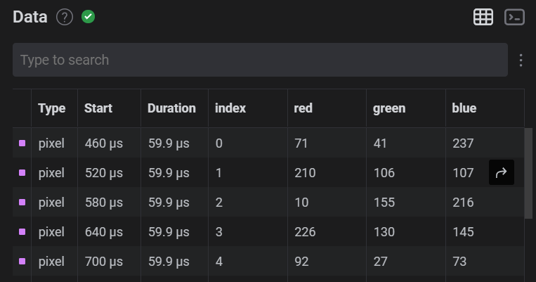

Screenshots:
Once you have added UseFrameV2(), and start Adding FrameV2s, you will see them in the data table like this.
