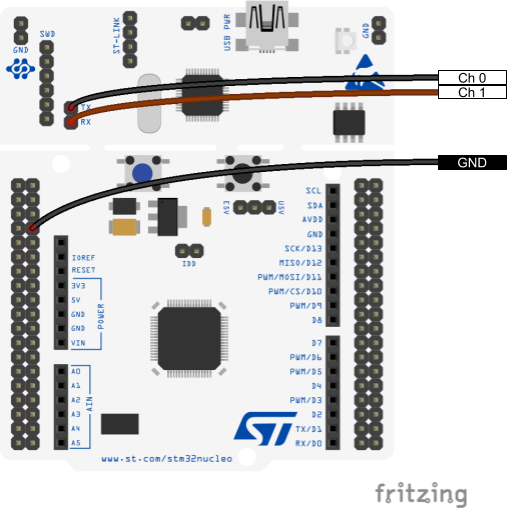

Note that on the Nucleo-F446RE, the UART lines used to communicate with the host computer are connected to the programming chip next to the USB connector. Arduino pins RX/D0 and TX/D1 are disconnected from these lines by default, which means we need to use the RX and TX pins near the programming chip.
Connect the GND wire to an available ground pin on the Nucleo. Connect Channel 0 to TX and connect Channel 1 to RX.

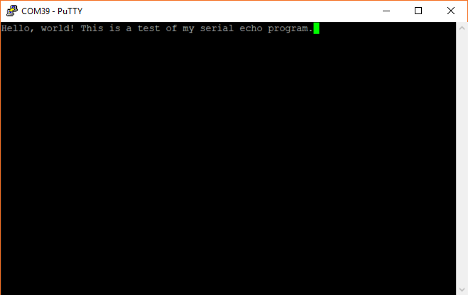

Download and open a serial terminal program. Here are some suggestions:
Connect to the Nucleo board over the assigned serial port with a baud rate of 115200, 8 data bits, no parity bit, and 1 stop bit (8-N-1). Once you open the connection, anything you type should be echoed back to you.

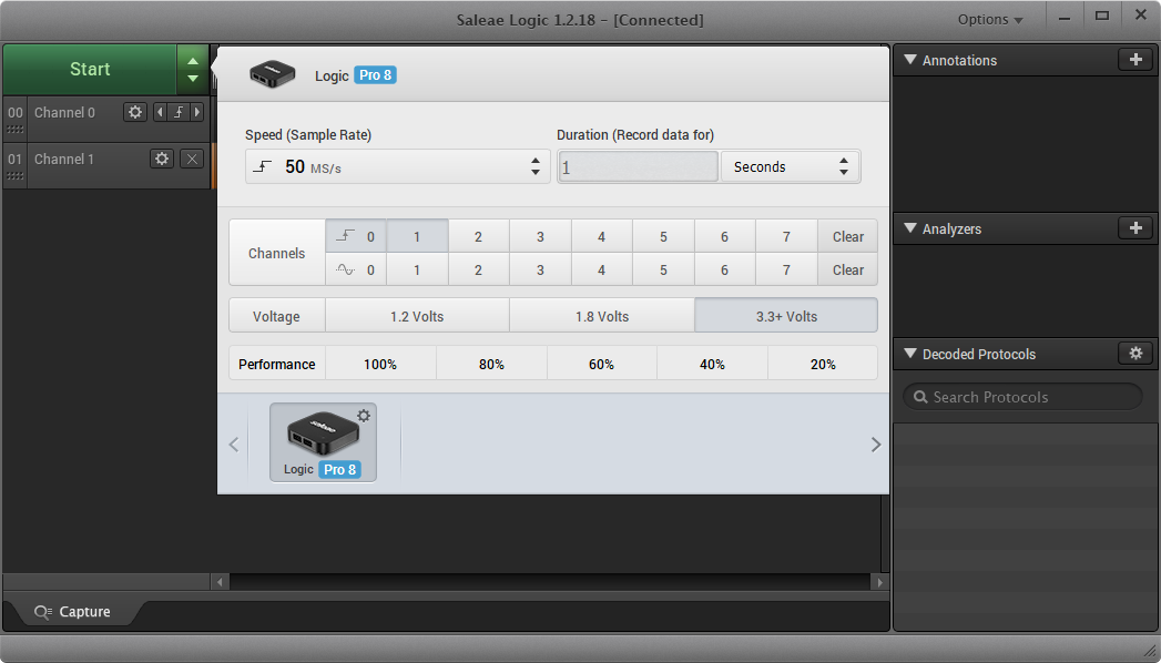

In the device settings window, set the speed to at least 50 MS/s and the duration to 1 second. Click both Clear buttons to disable all channels, leaving only the digital channel 0 enabled. Click the digital Channel 1 to enable it as well.
Click the Device Settings Button again to close the configuration window. With this setup, channel 0 is configured to capture UART data going from your computer to the Nucleo board (TX on the Nucleo), and channel 1 is configured to capture data from the Nucleo to your computer (RX on the Nucleo).

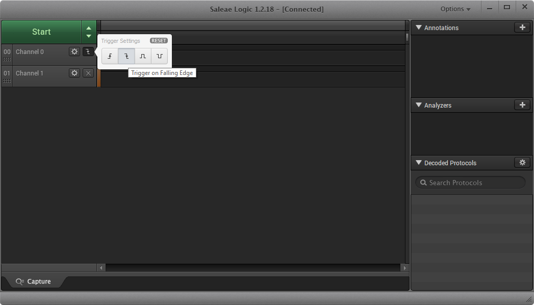

By default, triggering is set to occur on the rising edge of channel 0. UART is by default high, so we want to start capturing whenever the TX line drops low (start bit). Click the Trigger Button next to Channel 0 to bring up the Trigger Settings pop-up. Select the Trigger on Falling Edge option.
Click on the Trigger Button again to close the pop-up. Click Start, and you should see the Logic software tell you that it is waiting for a trigger.

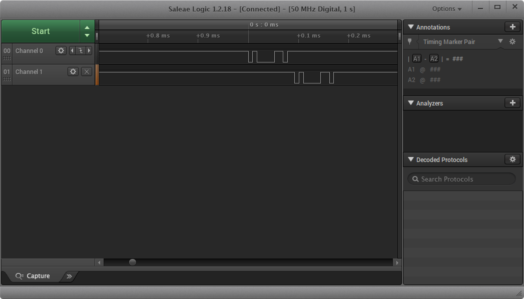

Back in your serial terminal program, type the letter ‘a’. The Logic software should begin capturing data and then show you the results.

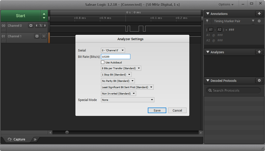

Click on the plus button (+) next to Analyzers on the right side of the Logic software. Select Async Serial to bring up the Serial settings window. Select 0 - ‘Channel 0’ for Serial, change the bit rate to 115200, and leave the rest alone.
Repeat this process to add an additional analyzer, but set the channel to 1 - ‘Channel 1’.

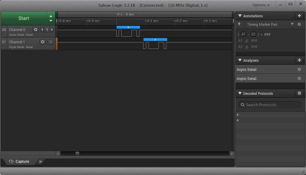

You should see two “Async Serial” bars appear under the Analyzers pane. Additionally, the captured serial data should both have the letter ‘a’ over them. This shows that you captured the ASCII letter ‘a’ going from the computer to the Nucleo and the same letter being echoed back.
Try measuring the time it takes for your Nucleo to capture and echo a letter, and see if you can type a few more letters during the capture period and decode them.
