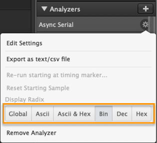

Every added protocol analyzer can be configured with a different display radix as shown below.
If you prefer to set a Global radix that all protocol analyzers will adhere to, then you can change it under Options > Display Radix.
