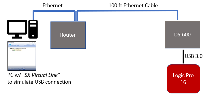

Limitations of Using Saleae Logic with the DS-600
Based on our tests, we have discovered the following limitations when using Saleae Logic over ethernet via DS-600 external hub. Please keep in mind that these results may vary depending on many factors such as available network bandwidth and PC specs.
  • Limited to 50 MS/s total digital bandwidth (e.g. 12.5 MS/s on 4 digital channels)
  • Limited to 6 MS/s total analog bandwidth (e.g 1.5 MS/s on 4 analog channels)
  • Cannot combine analog and digital recordings
These resulting limitations were gathered using the following test setup.
Test Setup with DS-600 Ethernet-USB Hub
