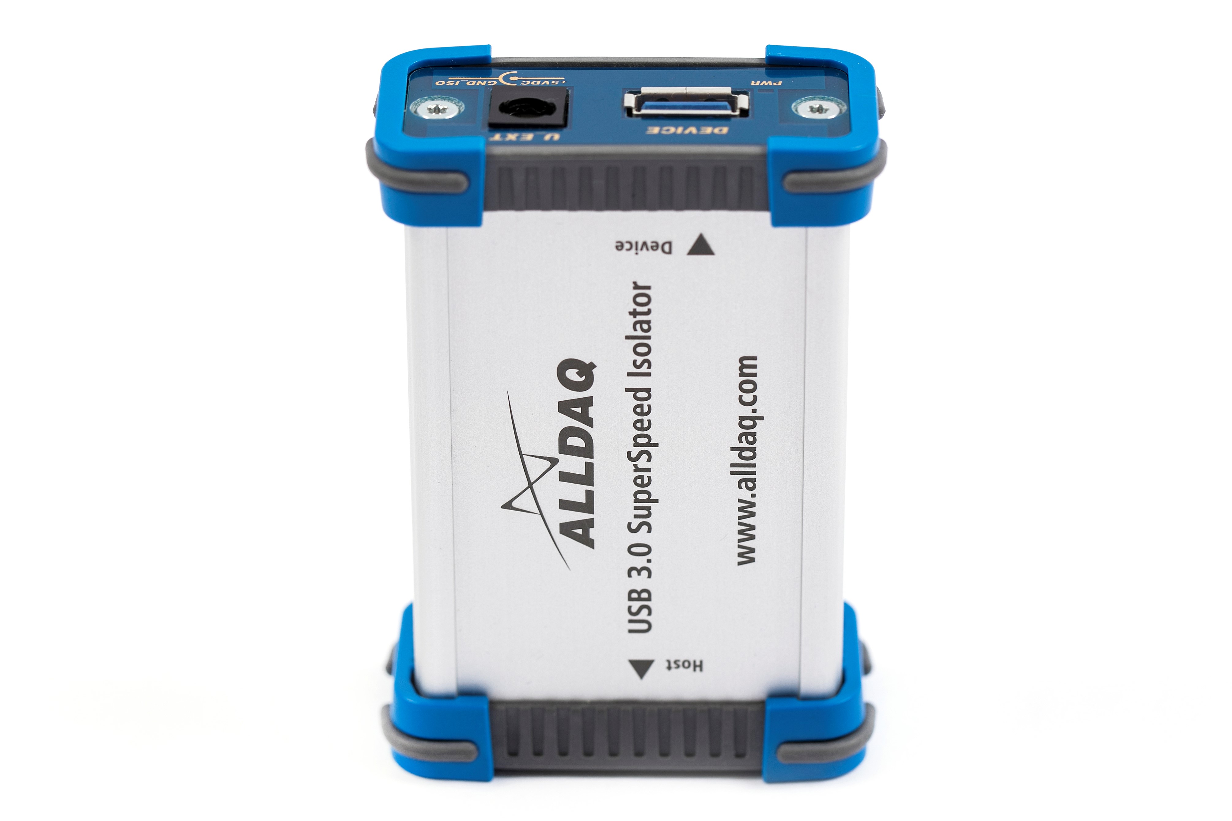

USB 3.0 SuperSpeed 1kV Isolator
The ALLDAQ USB 3.0 SuperSpeed Isolator pictured below is no longer available for purchase on our website. We’ve left it’s specifications here for reference. At the moment, this can be purchased directly from ALLDAQ.
- 1 kV continuous isolation (data and power)
- SuperSpeed USB 3.0 - 5 Gbps
- Backward compatible with USB 2.0 / 1.1 / 1.0.
- Provides 900mA when used with included power supply.
- Includes Power Supply for US, CN, AU, EU and UK.
- Compatible with all Saleae Logic Analyzers
- Rugged aluminum housing with rubber bumpers

Unfortunately, there is one limitation. It can only provide 300mA of current to the downstream port, which is less than the standard 500mA from USB 2.0 ports. This is not a problem for Logic 4 or Logic 8. However, Logic Pro 8 and Logic Pro 16 will require the USB 3.0 Super-Speed Isolator mentioned above.
