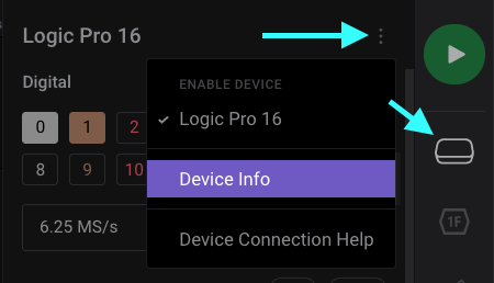

  1. Click the Device Settings Panel Button on the right
  2. Click the three dots next to your device name on the top-right

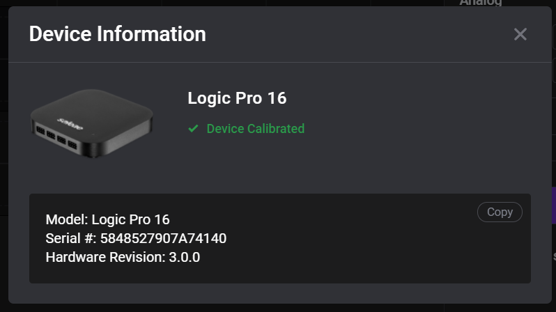

  3. Click Device Info to view the device’s calibration status and serial number
Opening the Device Information Window
Device Information window showing calibration status

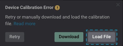

1. If the auto-download for calibration fails, a popup will appear.
2. Click “Download” to download the calibration file
3. Click “Load File” to load the calibration file
4. Check calibration status to ensure it is successful

  6. Open the Logic 2 app and connect your logic analyzer. You should be greeted by a Device Calibration Error popup below. Click Load File and navigate to the .cal file you recently downloaded. Your device should now be calibrated on this PC once the file is loaded.
Load Calibration File

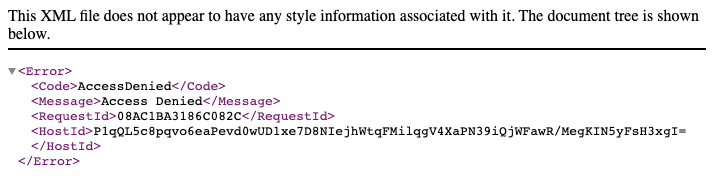

My Browser Opens the Following Page
When manually downloading the calibration file in Logic 2.x, in rare cases, your browser may open a page that looks like the image below.
Manual Calibration Access Denied
In this case, please submit a Warranty Request form and we will be happy to help. This may be indicative of hardware failure and we’ll most likely want to process a warranty for you.
