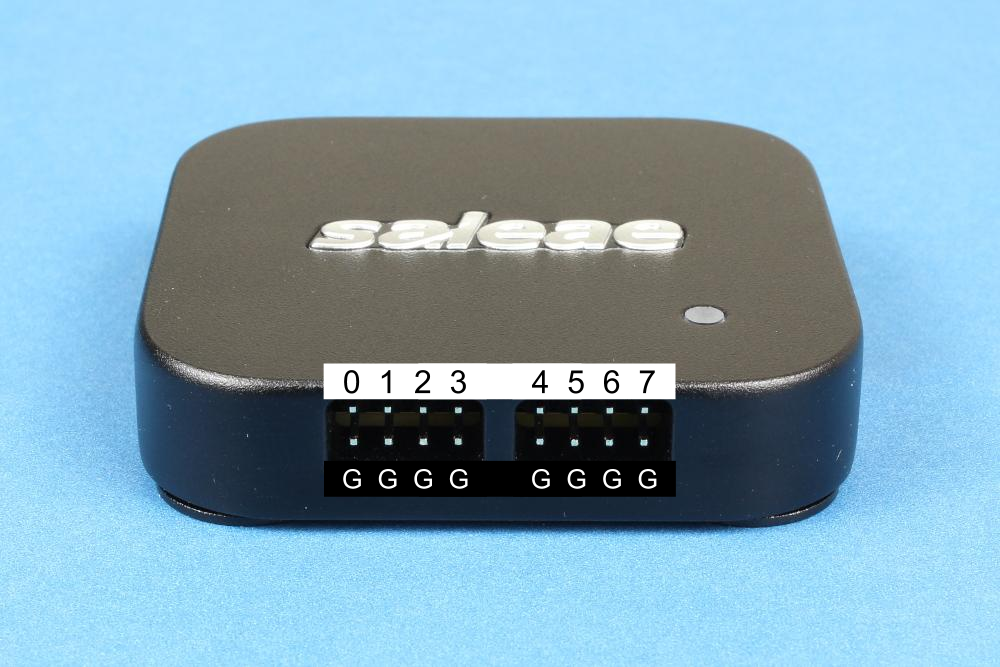

Our Gen 2 devices (Logic 4, Logic 8, Logic Pro 8, and Logic Pro 16) have a ground lead for each signal. You can refer to the image below for the location of the ground pins.
Logic Pro 8 Channel Pins and Ground Pins
