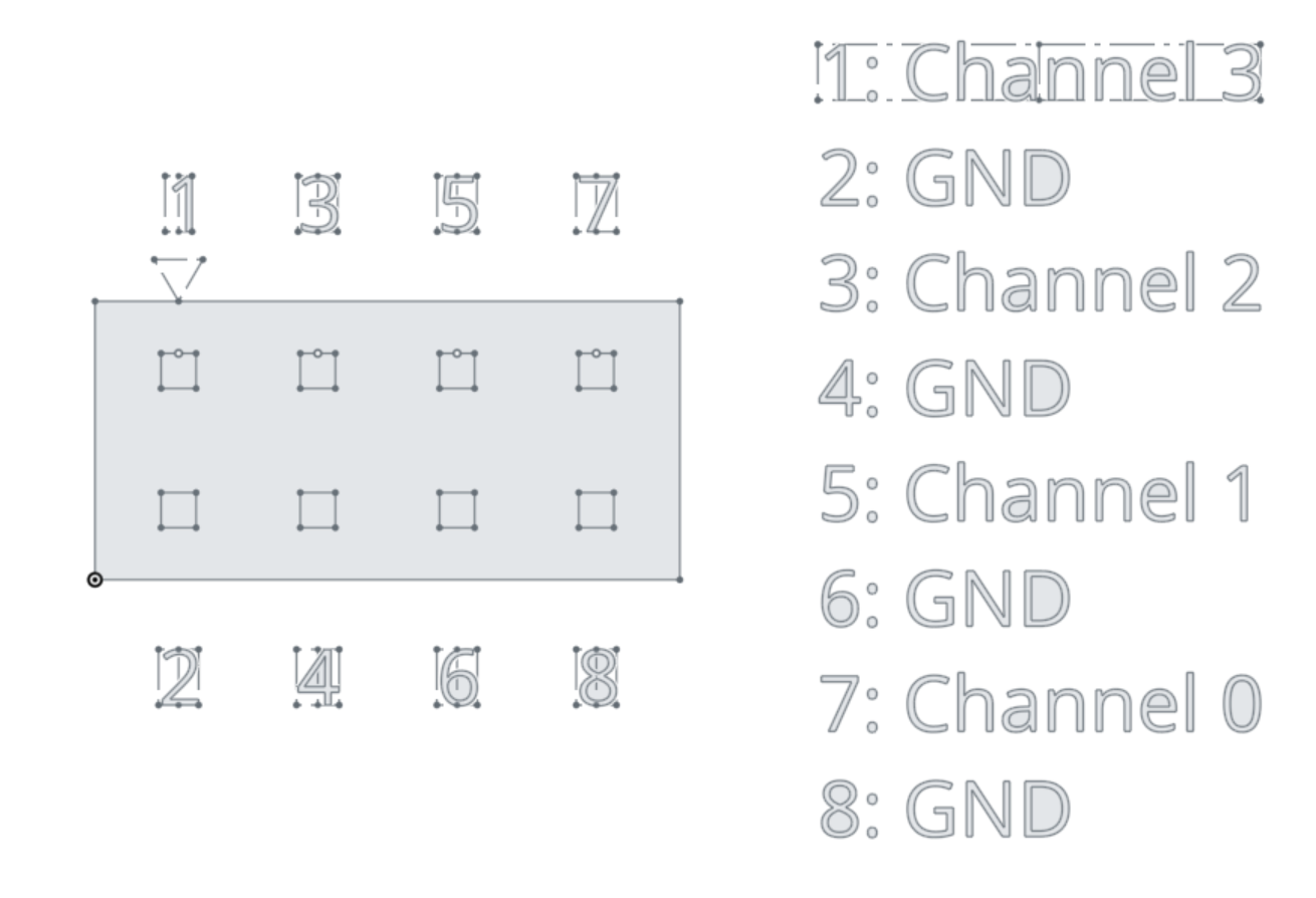

When using the Gen 2 Logic-to-2x4 header adapters, please use this pin out on your board (top view):

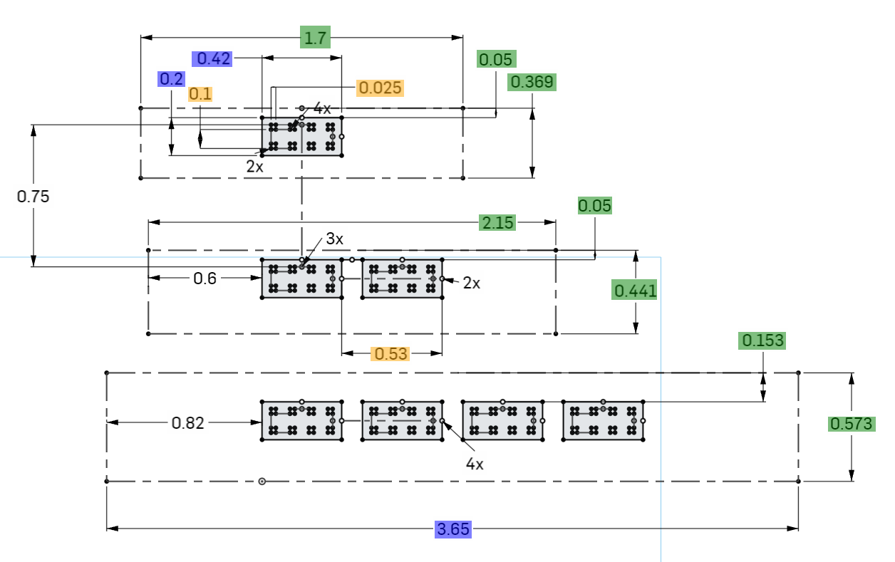

Dimensions for the Connectors
Below are diagrams of the connectors on the new Saleae logic analyzers. Note that Logic 8 and Logic Pro 8 have the same dimensions.
The dimensions for the connectors on our Logic products are available on OnShape, named Saleae Pinout Gen2. A free account is required with OnShape to view them.
