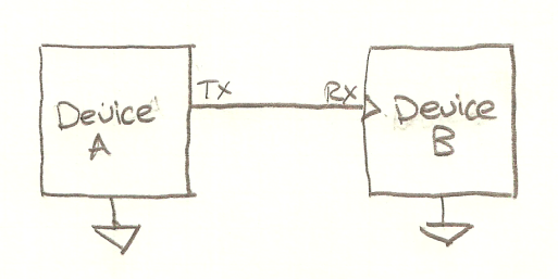

When we talked about asynchronous serial, recall that the receiver was responsible for figuring out exactly when a bit should be read from the bus. To do this, we used a timer and kept track of how much time had elapsed. At certain time intervals, we would record what was on the bus.

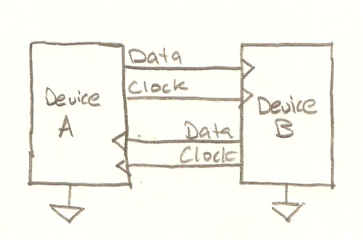

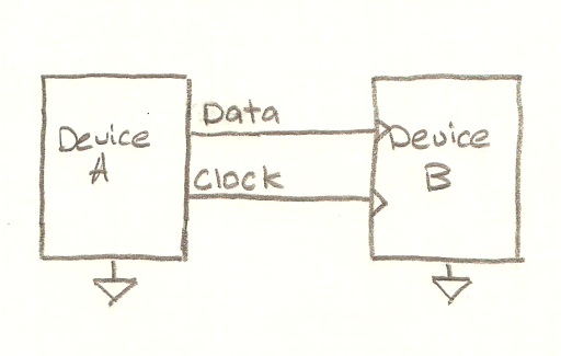

With synchronous serial, things are more straightforward. We are explicitly told when we should read the data line. To do this, another wire is added (for a total of 2 wires). This other wire, called the clock line, tells us when to read the data line.
How the Clock Line Tells Us When to Read the Data Line
There are several ways in which the clock line could tell us when to read the data line. For example, maybe we should read the data line whenever the clock line is a logic 1. A better way is to use the “edge” or “transition” between logic states to indicate that the data line should be read. This has the advantage of being a single event—a single snapshot in time—rather than a region of time. This reduces any ambiguity about when exactly the data line should be read.

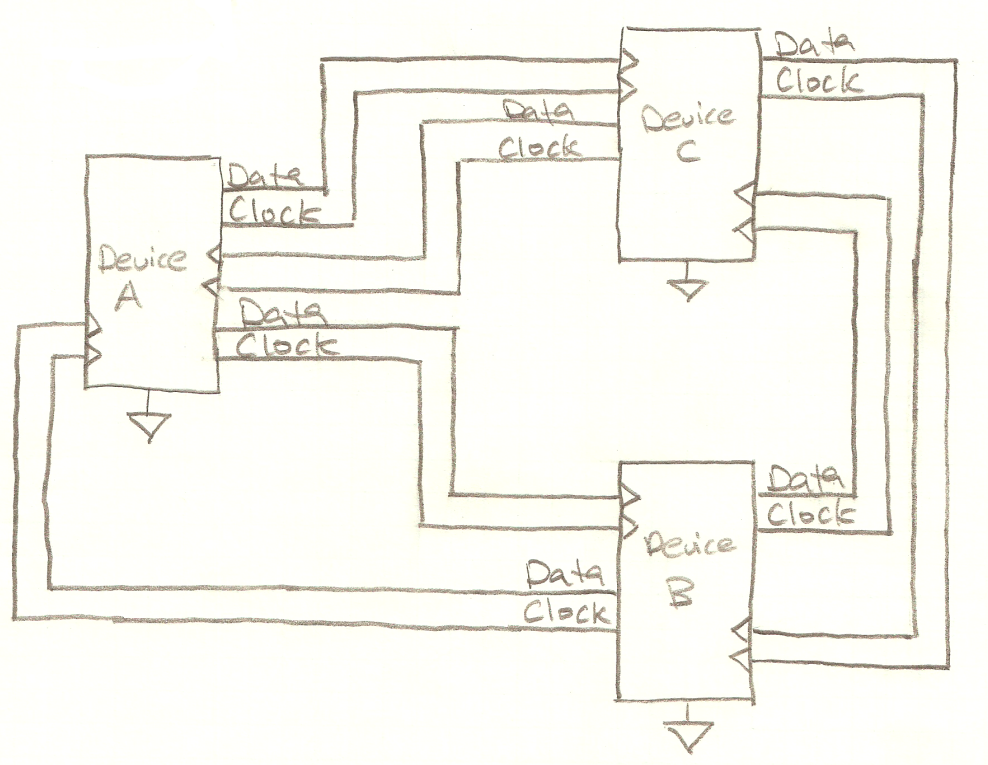

Point-to-Point Connection
There are many possible ways in which a synchronous serial could be used with more than two devices. One simple way is that each pair of devices that needs to communicate has dedicated connections. Notice, however, that the number of connections you need grows geometrically. So this isn’t a great solution.

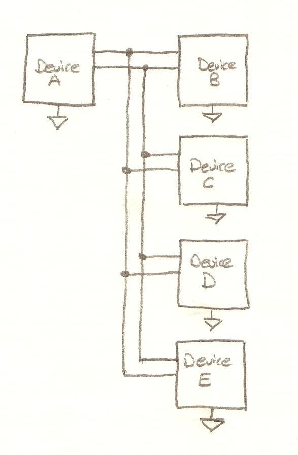

Bus
A bus is a collection of wires shared by many devices.
Notice that a bus uses far fewer connections. However, there are some limitations:
- Only one device can “talk” at a time.
- If two devices talk at a time, this is a “bus collision.” Imagine what happens if one device outputs a 0 at the same time another device outputs a 1. That is a short circuit!
- A device needs some way of knowing if someone is already talking on the bus.
- The bus needs to recover from potential conflicts and have a way to figure out who gets to go first.
While a bus topology like the one shown is very powerful, it requires electrical- and protocol-level complexity to deal with the issues raised above. It’s not ideal for very cheap and simple devices.

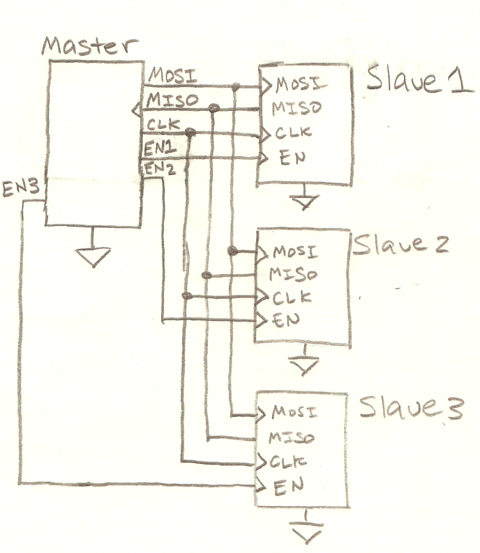

Only One Master
In SPI, only one of the devices is in charge. It alone decides who can talk on the bus. Furthermore, devices can only talk to the master device; they can’t talk to each other.
The Lowly Slaves
All other devices on the SPI are called slaves.
Choosing Which Slave Gets to Talk with the Master
In SPI, the master uses an enable line for each and every slave. In this way, the master can select which slave is active. Generally speaking, only one slave can be active at a time.
SS or EN
In SPI, the enable line is usually called SS (slave select) or EN (enable). It’s all the same thing.
Enable (EN or SS) Is Active Low
The SPI enable line is almost always inverted: 1 means disabled; 0 means enabled.
Communications with the Active Slave
MOSI
In SPI, the master has a dedicated data output line called MOSI (master out, slave in). All the slaves listen on this line but ignore it if they are not active. In SPI, data are typically sent most significant bit first (MSB first).
MISO
The master also has a dedicated data input line called MISO (master in, slave out). Only the active slave is allowed to transmit on this line. All the other slaves MUST transition to high-z mode when they are not active (i.e., they may not drive the line). This is the function of a tri-state buffer. In SPI, data are typically sent most significant bit first (MSB first).
CLK
Since this is synchronous serial, there needs to be a clock, which is typically called CLK. The clock is used with both the MOSI and MISO data lines.

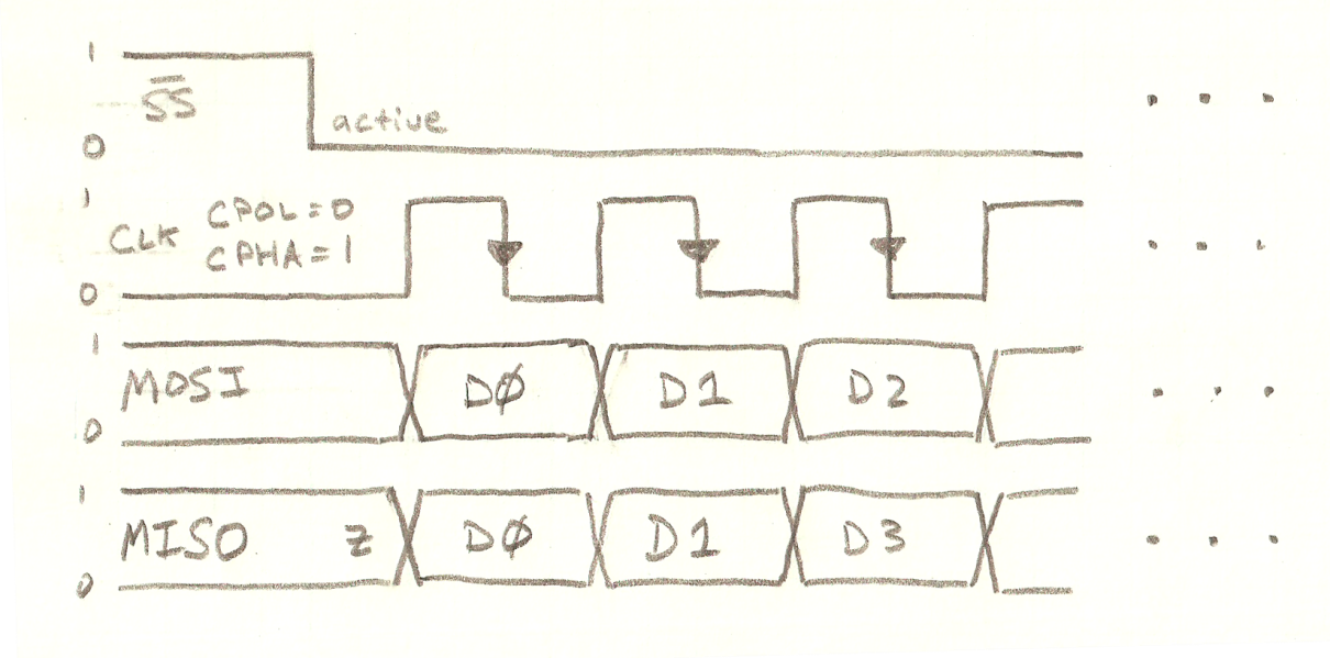

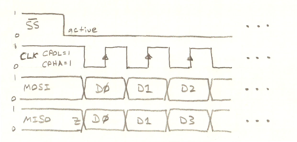

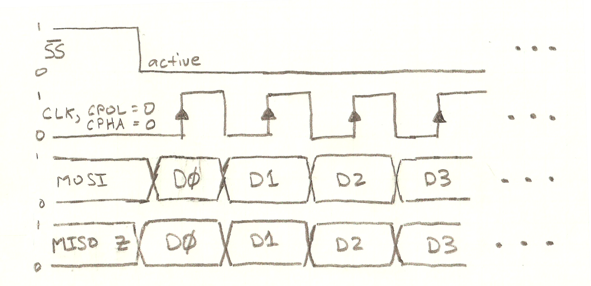

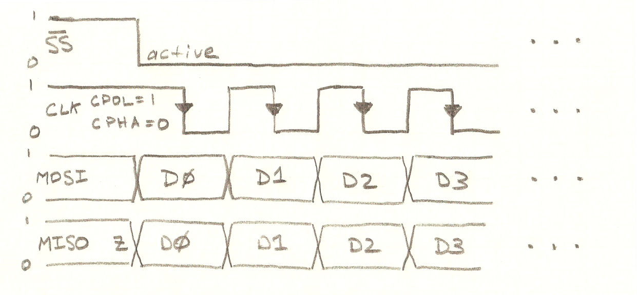

Clock Polarity and Phase – CPOL and CPHA

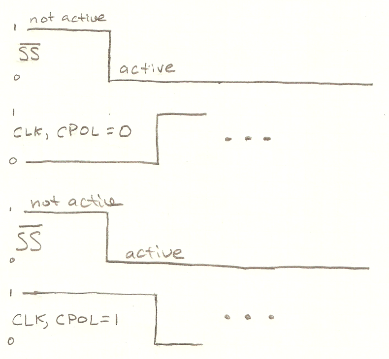

Datasheets specify the previously mentioned details in terms of clock polarity (CPOL) and clock phase (CPHA). An additional complication is that the slave must generate output data on MOSI such that its data will be valid when the master reads it in accordance with its own CLK signal. That is a little backward. Clock polarity (CPOL) is the state of the clock at the moment a slave’s enable line becomes active. CPOL=0 means that the clock is low (0) as the slave becomes enabled. CPOL=1 means the clock is high (1) when the slave becomes enabled.
At some point after a slave becomes active, the clock likely will change. If the data on MOSI and MISO should be read on this first edge, the Clock Phase (CPHA) is 0. Alternatively, if data on MOSI and MISO should be read the 2nd time the CLK changes, the Clock Phase (CPHA) is 1.
CPOL=0 (the clock starts out low) CPHA=0 (data is valid on the 1st clock edge)
CPOL=0 (the clock starts out low) CPHA=1 (data is valid on the 2nd clock edge)
CPOL=1 (the clock starts out high) CPHA=0 (data is valid on the 1st clock edge)
CPOL=1 (the clock starts out high) CPHA=1 (data is valid on the 2nd clock edge)
